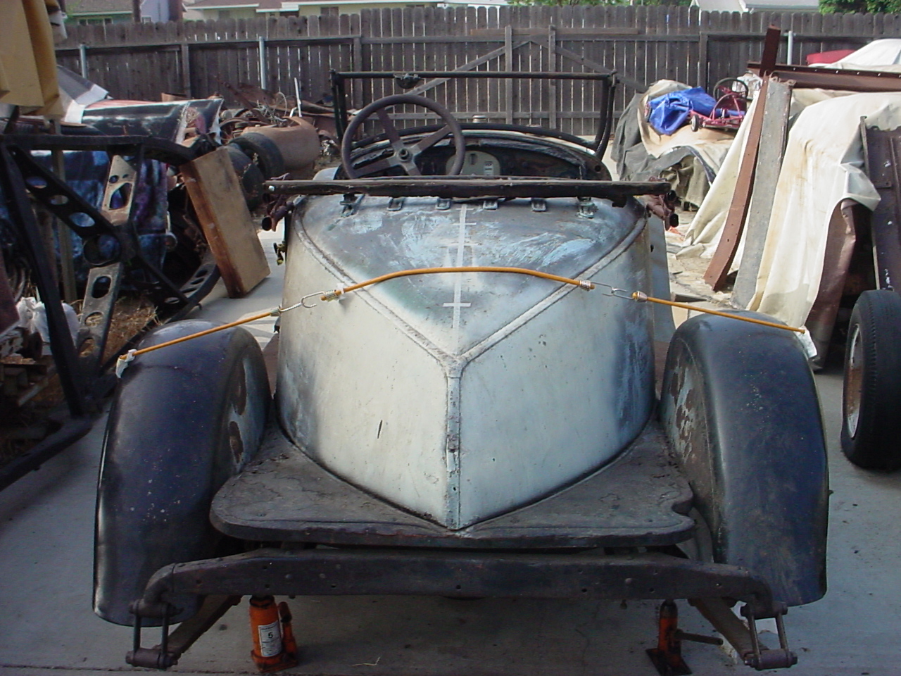

She's about 80% there, it's a 1927 Essex. By the way, I'm just kidding about the rat rod stuff. Anyone have one of these? My Dad needs some info and a few parts.:)

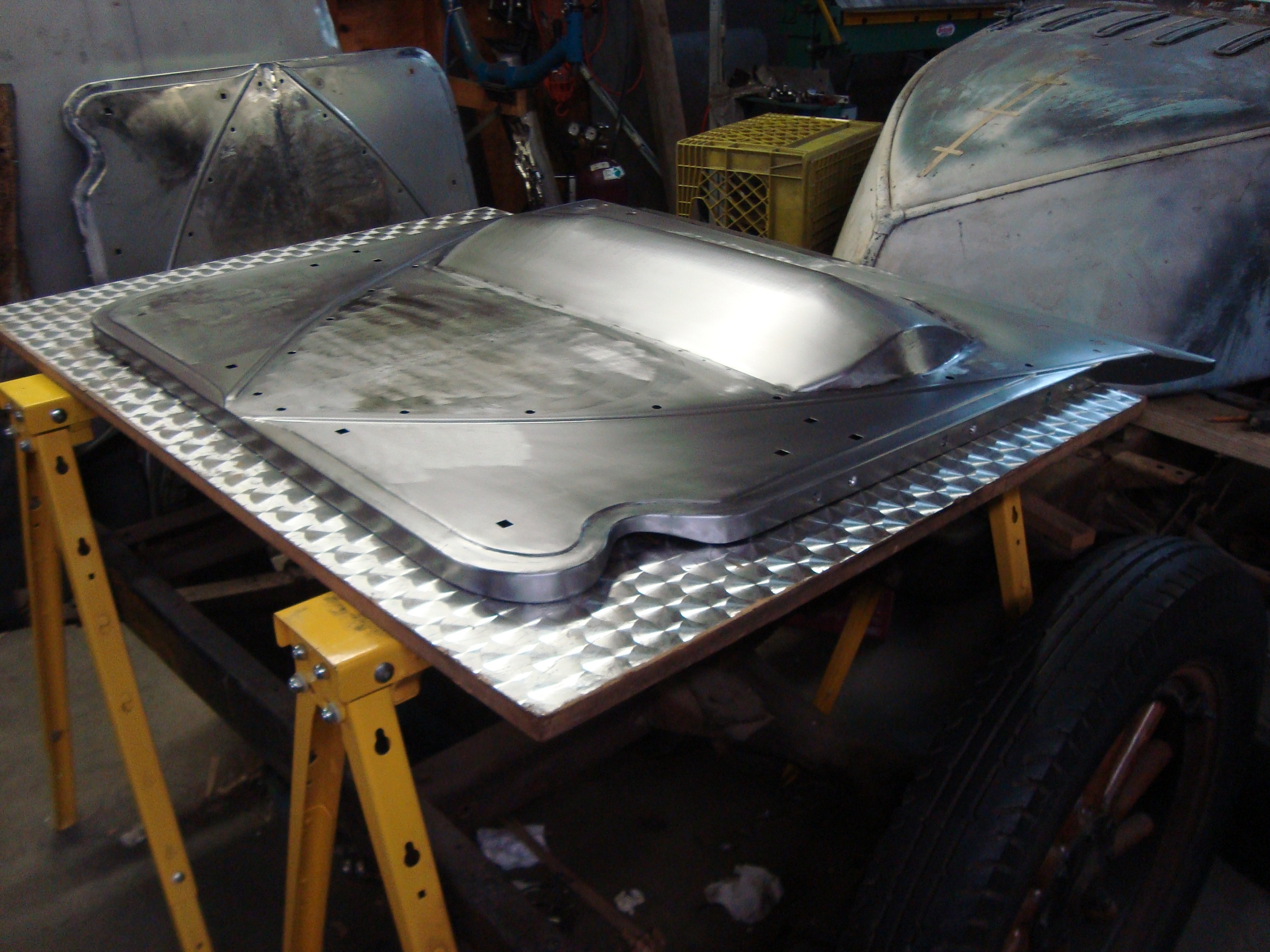

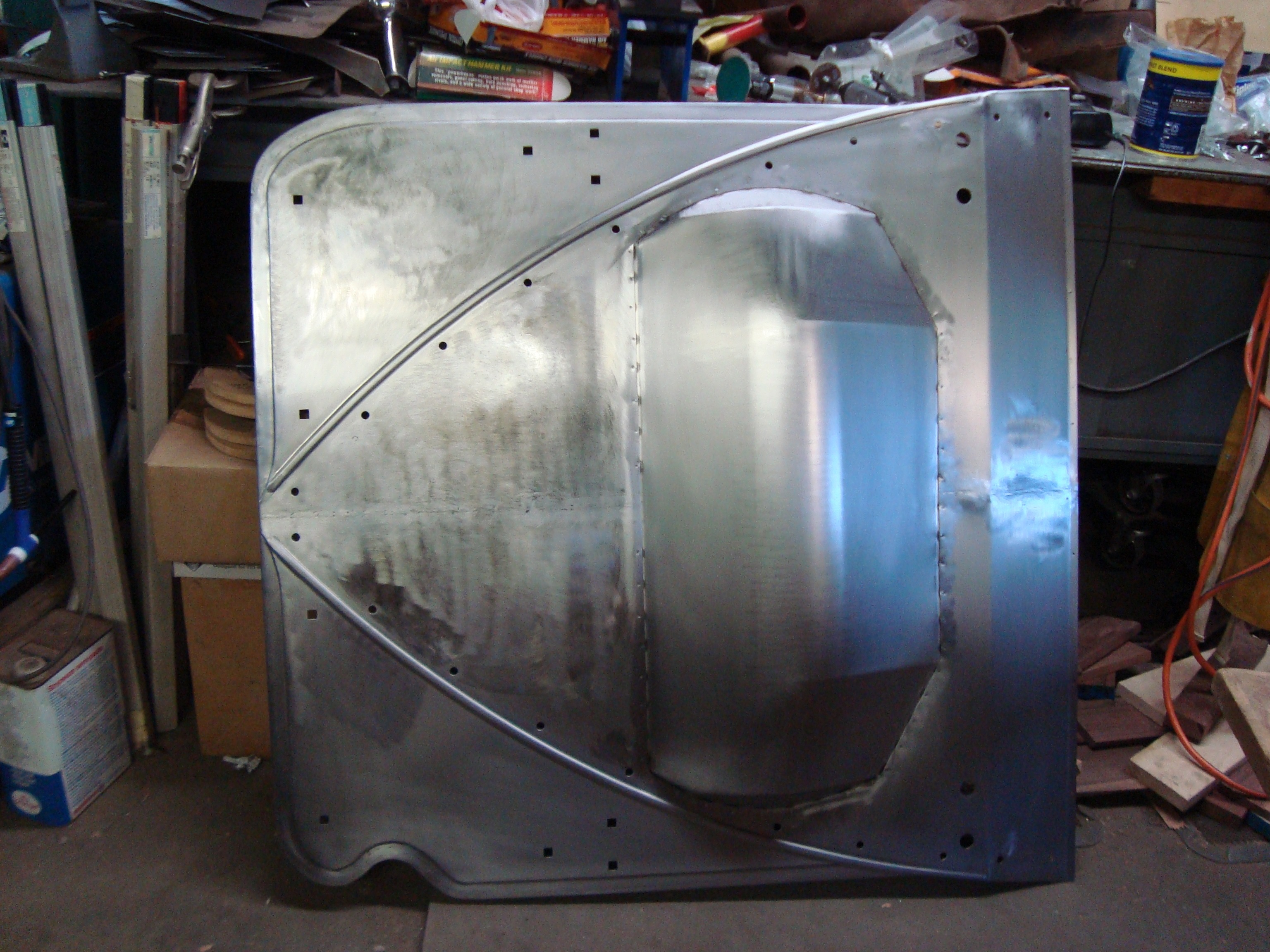

Well, I was sorta joking about the rat rod thing. I couldn't rat rod an original car that is so rare. ...BUT, if I made a copy of the car just out of new flat sheet metal?!?! Now THAT I could rat rod!
Body panel number one, pretty much done.
Hi Bent Metal,
Nice work on the Boat Tail deck.
Peace,
Chaz0 -
OH, to be able to panell beat , looks like a very nice job
Mike0 -

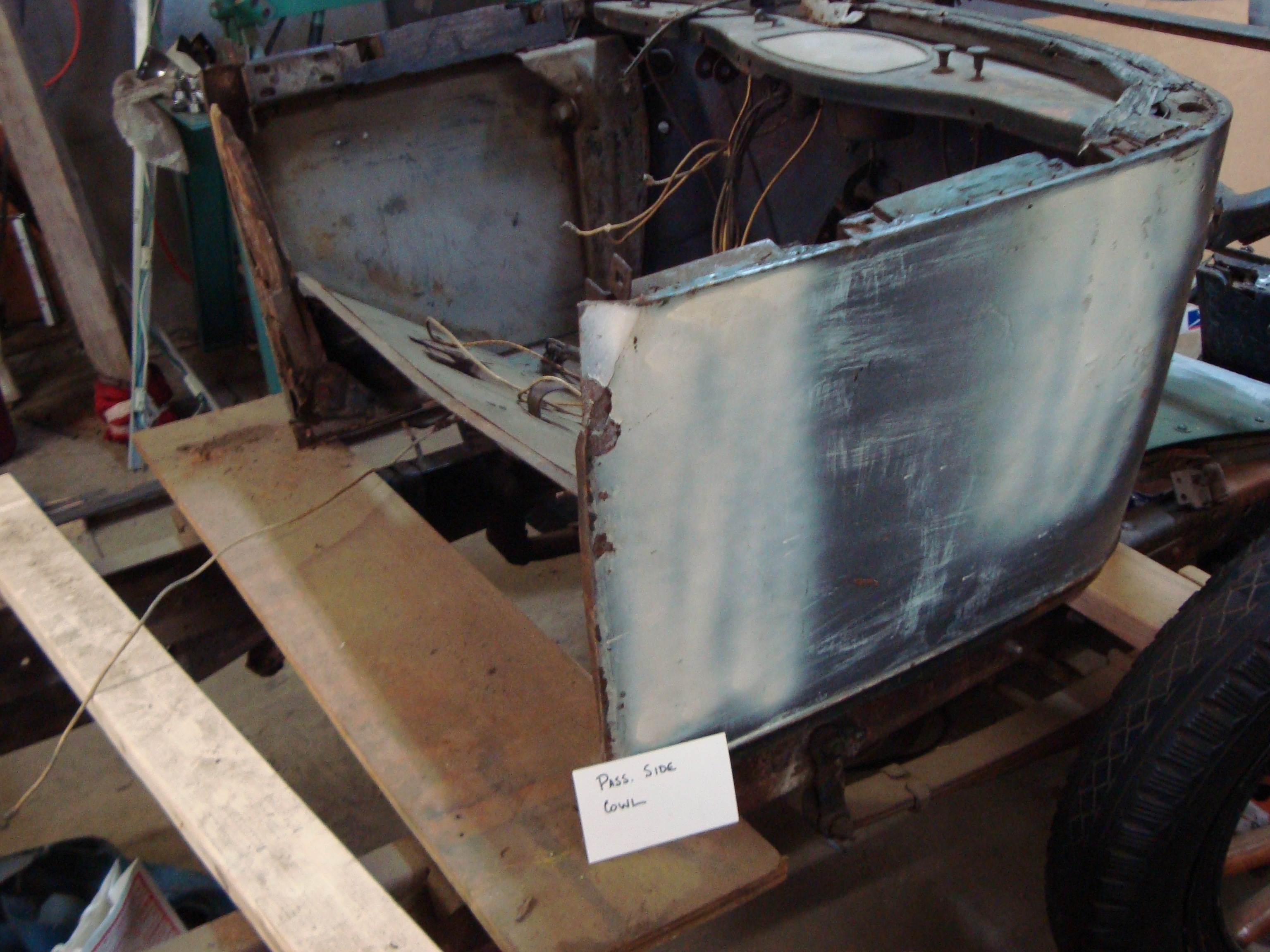

I've been messing around with this car, off and on for a little while now. Mostly taking it apart and trying to locate missing parts. Mr. Brintnall has been a fantastic help in filling in the blanks.:)
Still a long way to go. But it's starting to go back together, slowly.:)0 -
Gorgeous work- I love seeing stuff like that.
But what's the story on the engine-turned piece that your part is laying on in the center photo? That's kind of impressive, as well.0 -
Mike (WA) wrote:Gorgeous work- I love seeing stuff like that.
Oh the table top, it's just an old piece of MDF with a veneer of stainless that has that pattern cut into it. I had that sitting around in my shop for a year or two. Wanted to do something with it but never came up with an idea. So, I decided to use it as a table top and it works good for that.0 -

Bent,
To say that you are a sheet metal master would be an understatement. Terrific work! Keep the pics coming as you progress.0 -

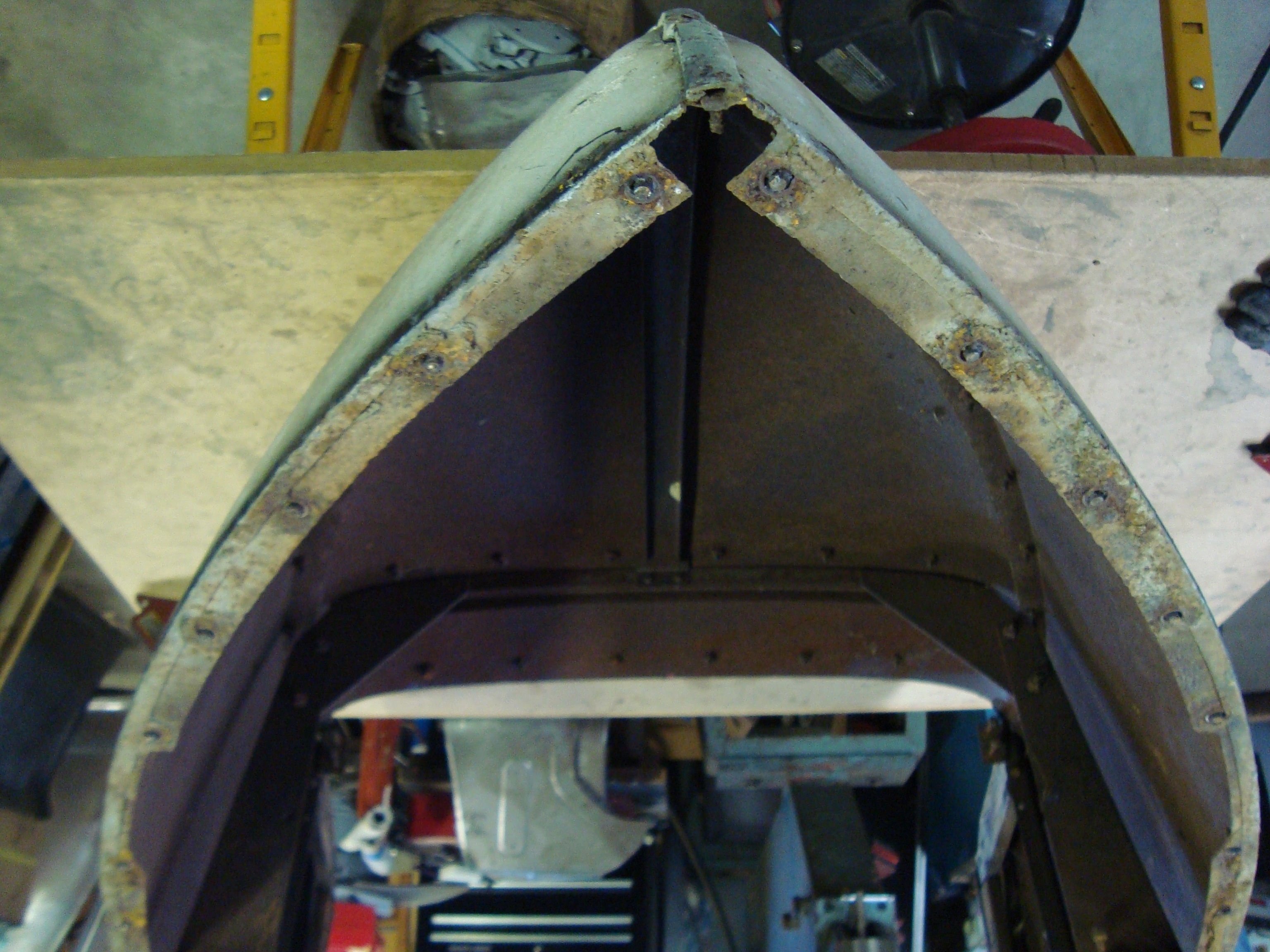

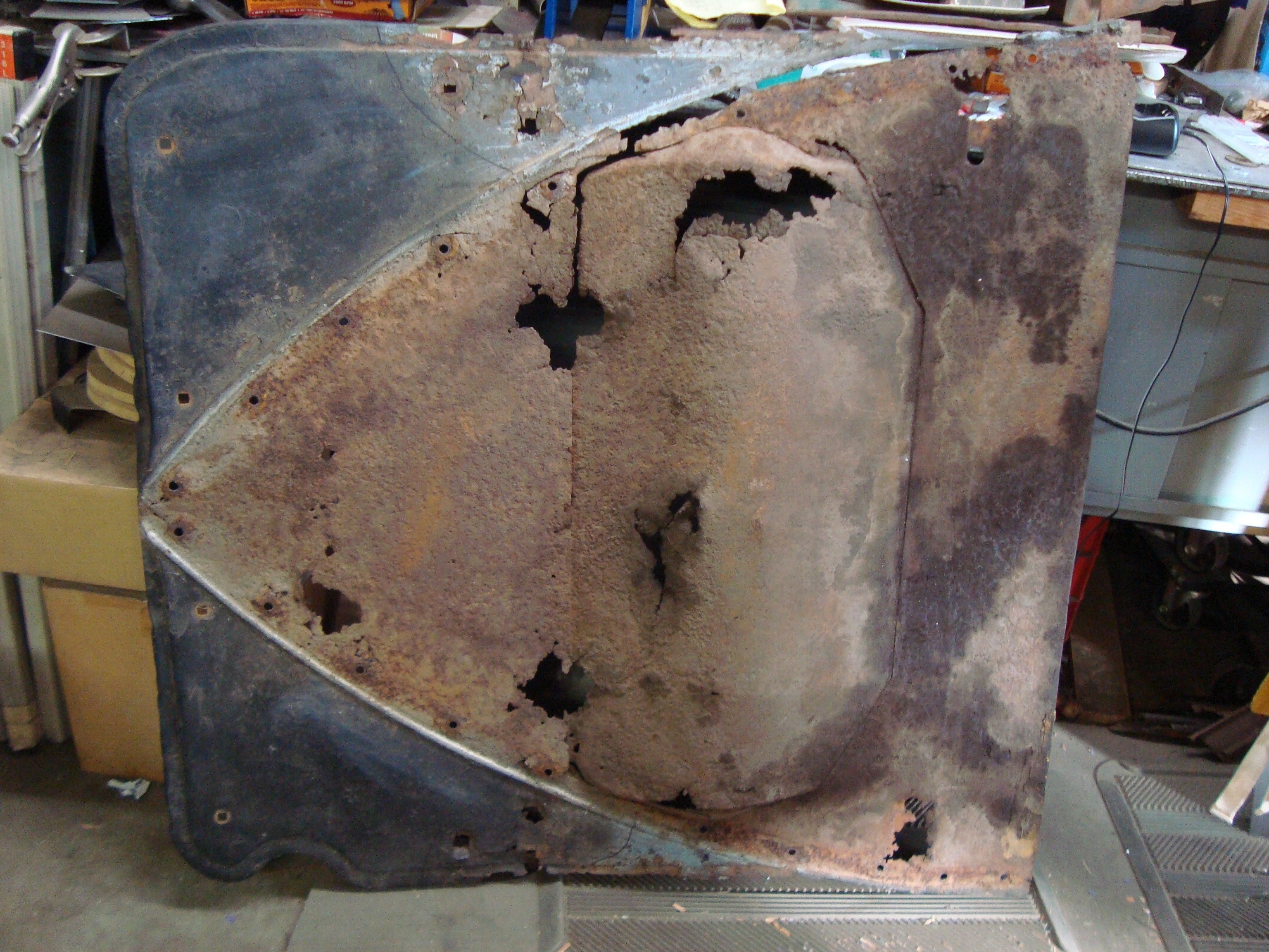

Some body mount brackets that rusted where they bolted to the wood.
I'm trying to keep as much as possible and only remake the areas that are too rusty to save. Not just remake everything.:)0 -

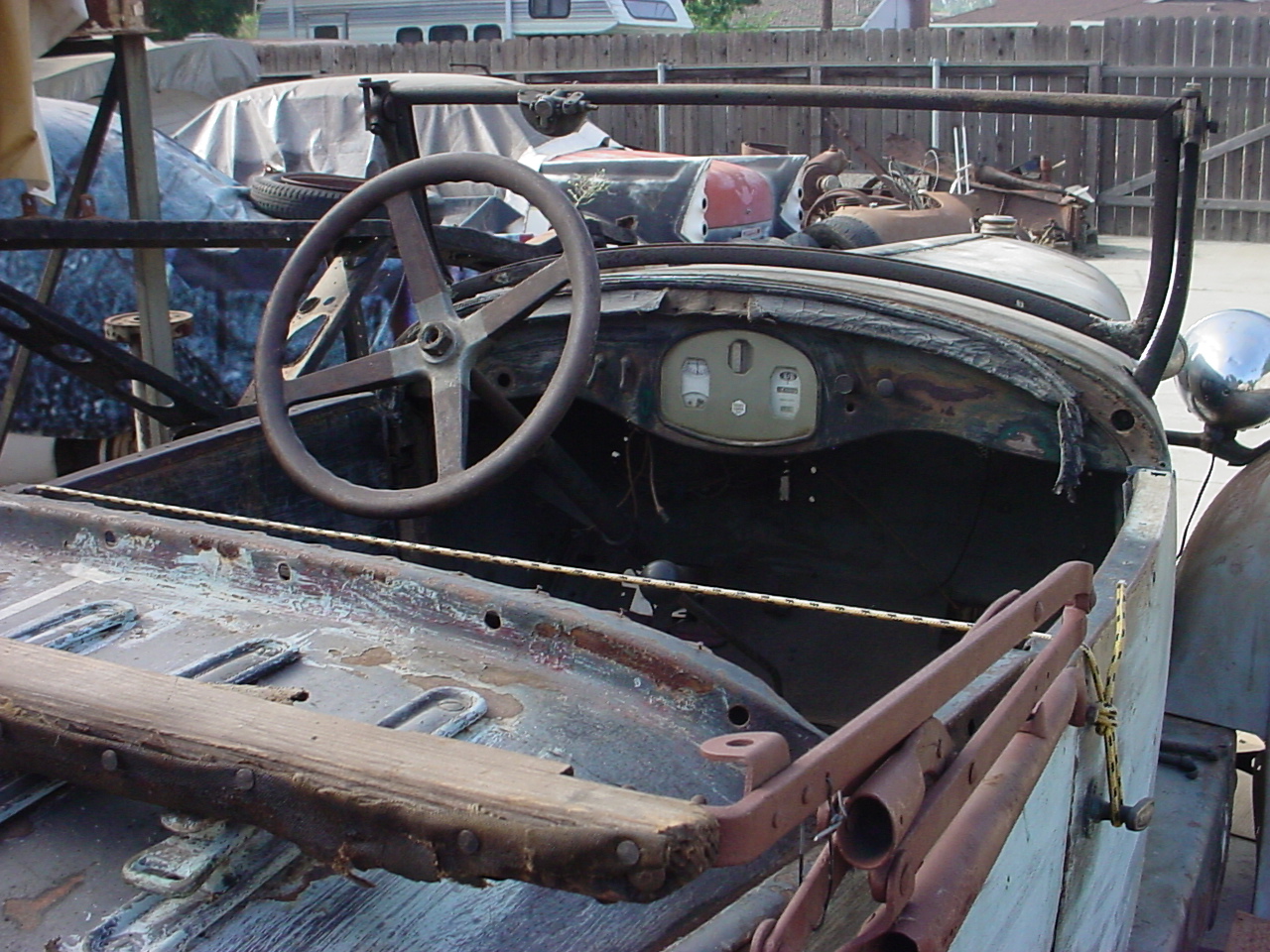

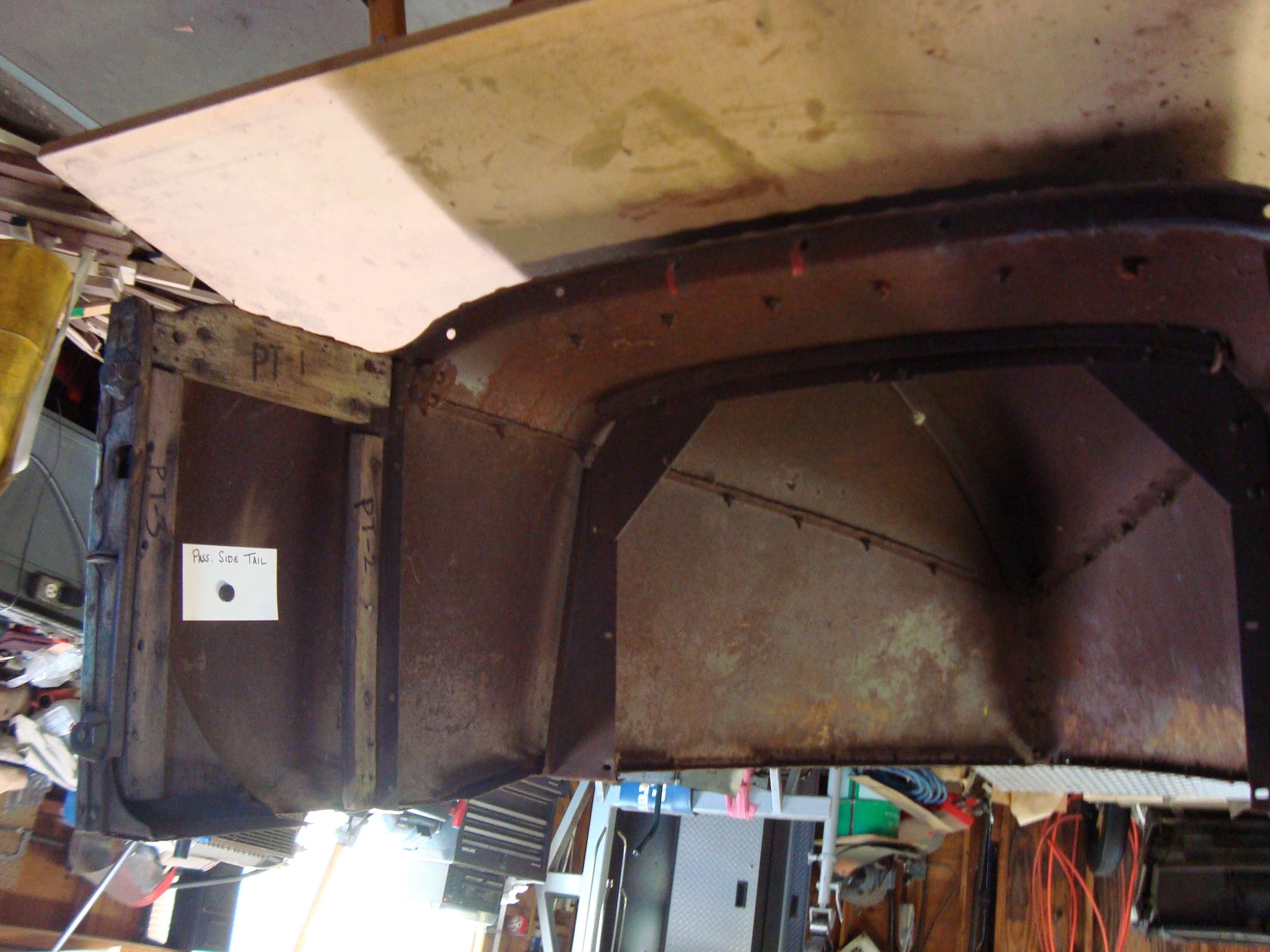

Started on the rear fenders. Not finished yet. Just got the worst of the rust gone.0
I'm sorta jumping around on this car. More so then I normally do, because I want to make sure all the pieces flow together when it's done. The way it's constructed is more like a carriage mixed with a car. Some of the panels are only held in with nails. Others are reinforced with wood and some with both metal and wood. It's been interesting to disect the whole thing and see how they made it.0 -
