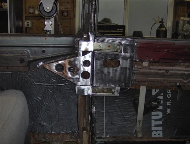

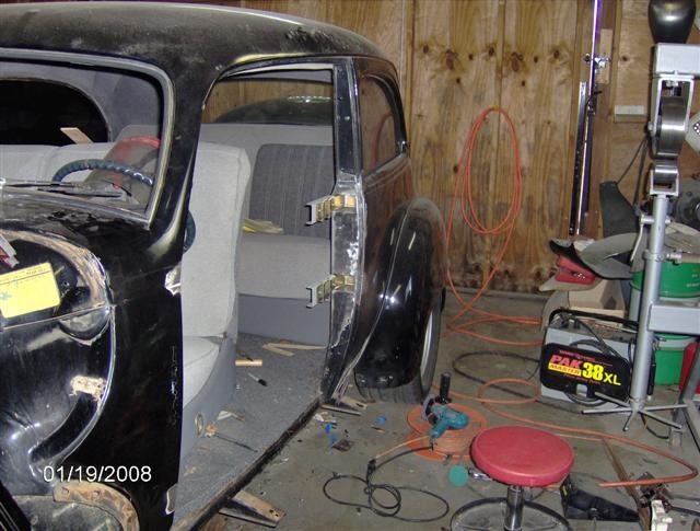

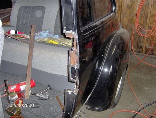

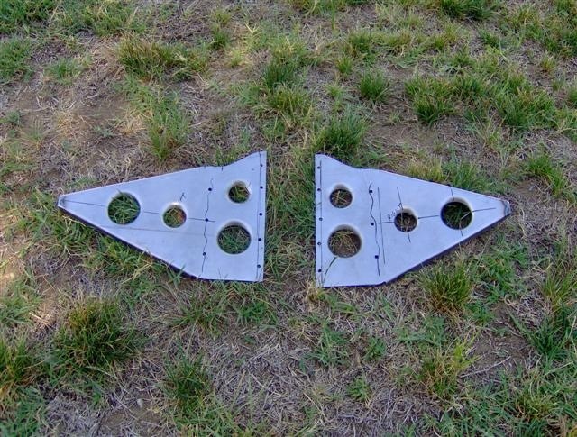

If you got a 47' and don't want to see that bottom hinge sticking out,...suicide doors might be your solution. I always forget to take before and in process pictures. But, here's a few. About half way through.
This gave me an idea. Hey "Ron P", how about lambo doors on your twenty-nine?:D<img src="https://openforum.hetclub.org/uploads/FileUpload/ce/e1529affa7aaa300abe1d2a6652d40.jpg" />
The reason I had to widen the jamb is to fit the big hinges. They are the heavy duty ones from Auto lock, don't even get me started on that! Very dissapointing.0 -
Man, I wish I could do work like that! I think suicide doors would be cool on my '48 sedan. Keep up the good work.0
Thanks, it's taking a little longer then I planned. I wasn't expecting to have to remake the jamb area. Got a lot more to do too, fill the cowl vent, de-chrome, make new running boards (this car had the interrior kind) lots to do.:)0 -
Nice work - that body style lends itself to installation of that style hinge and will have a nice clean look.

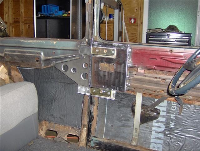

This is that bracket installed. Probably not totally needed, but it can't hurt.....hmmm, geez I take bad photos.:(0

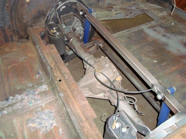

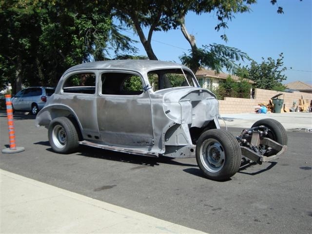

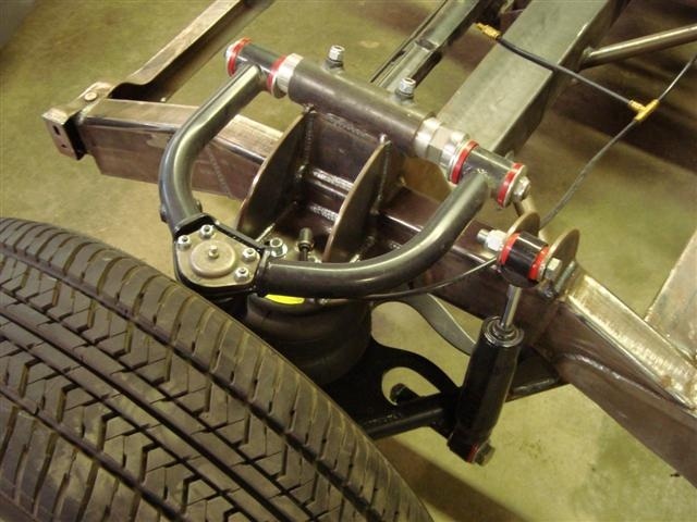

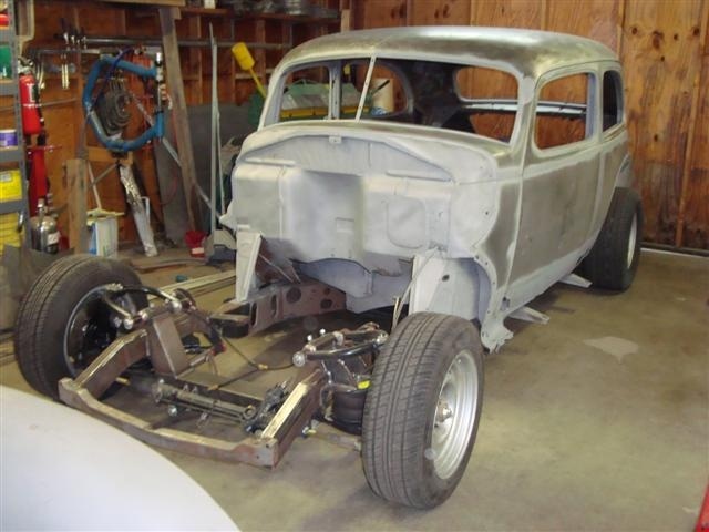

She is back from the blaster and it looks like their will be a lot to fix. But, not so bad. Check out the front end, and rear that No Limit put in, nice!:)0 -
Very nice work dude! Thanks for the pics. I'm really interested in your rear end set-up. Are those homemade bars on it? I want to do an airbag rear-end set-up on my '50 Coupe.0
I don't know if the bars are hand made or what. I only do sheet metal, the front and rear frame work was done thru "Mueller's Muscle Cars" in Southern California. Here are a few more pictures for you.:)0 -
