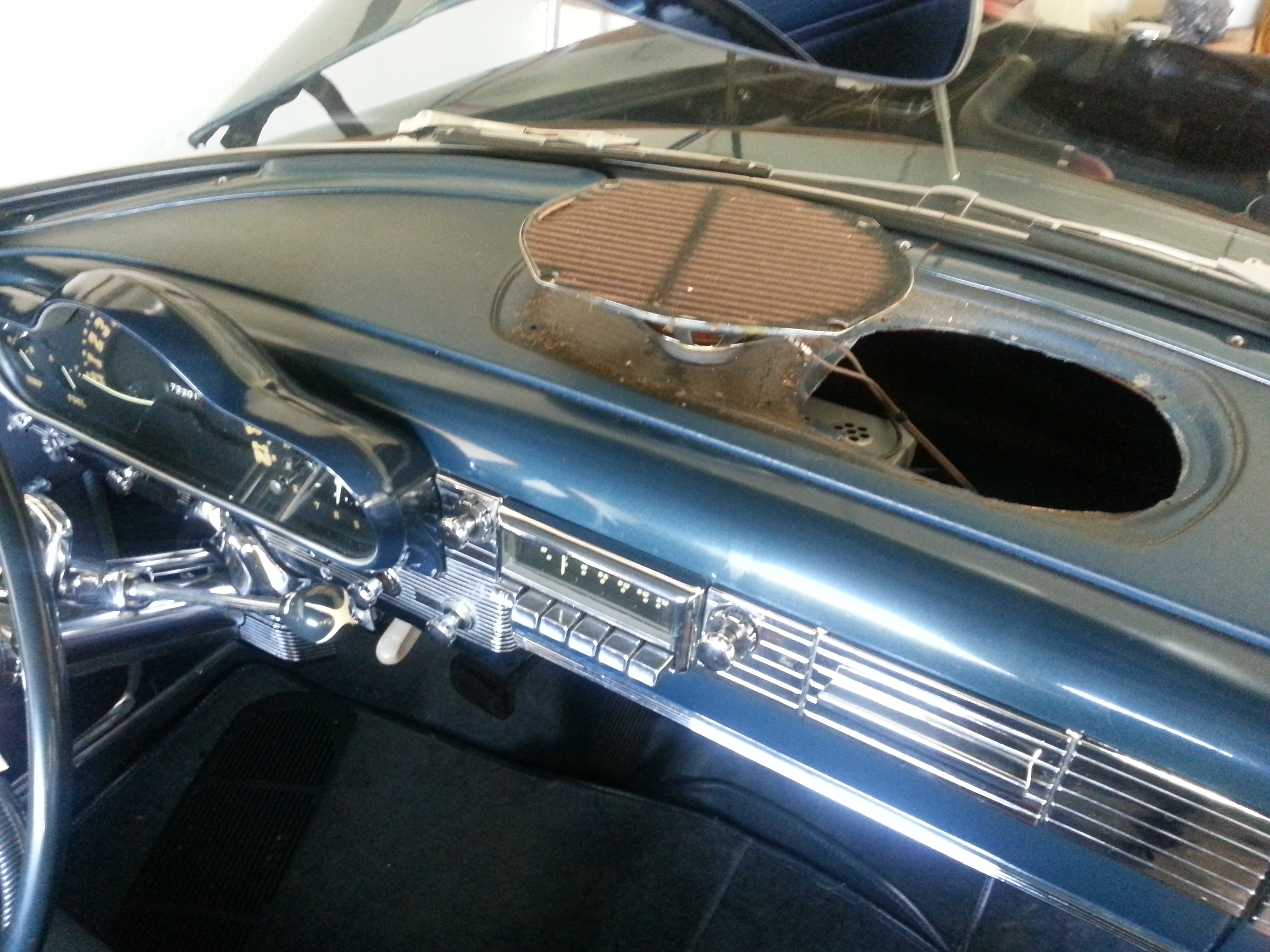

I don't know if this is helpful, but I have a pic of the speaker out of the dash on my phone. The radio works - it was rebuilt, but I have no idea if this is a replacement speaker or OEM. Seems to fit perfectly, though.0

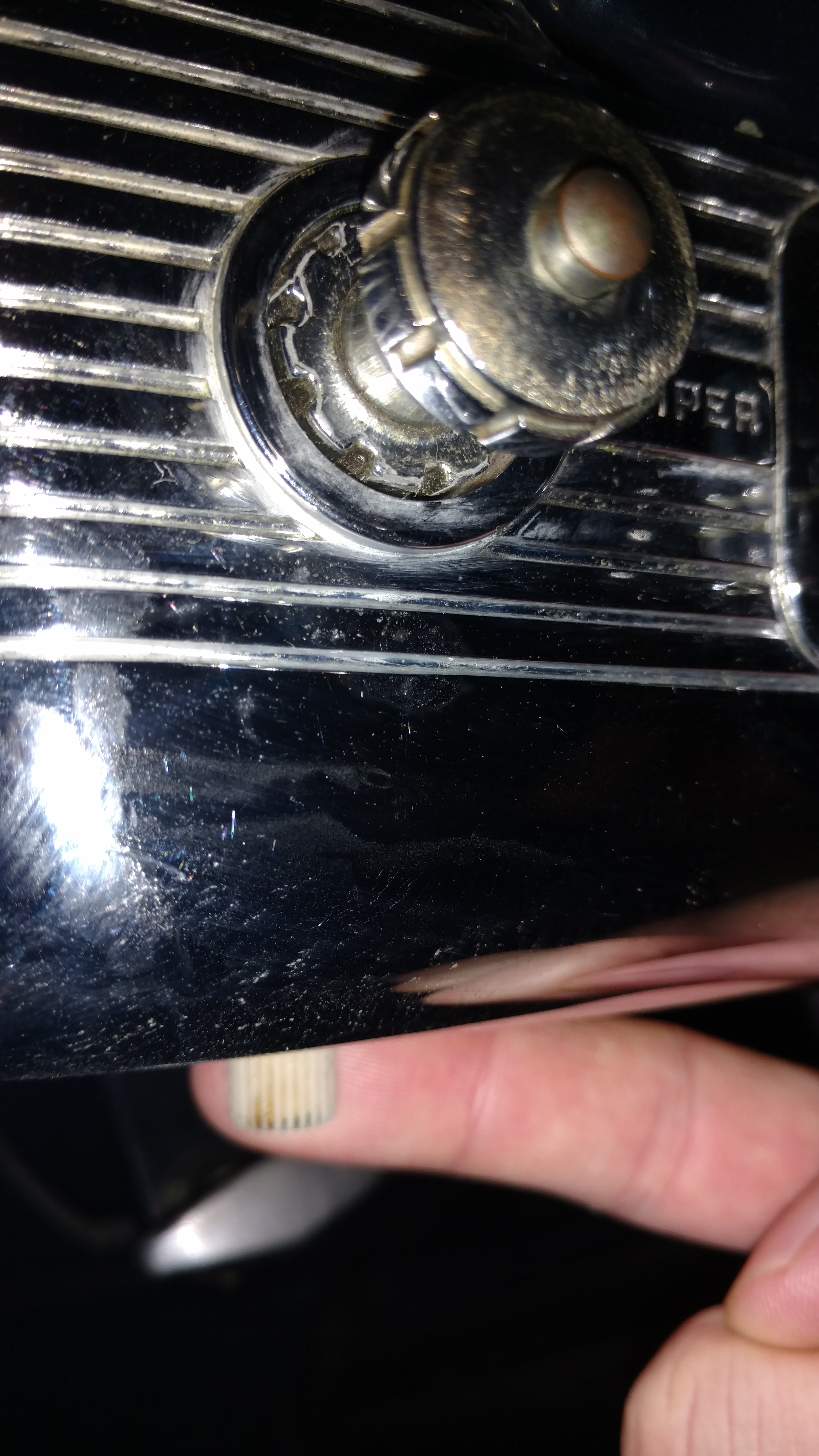

Here's a picture of the dimmer switch. It's under the dash, below the cigarette lighter, all the way on the left.0
Hornets should have the dimmer. The less espensive cars lost the dimmer due to price constraints.

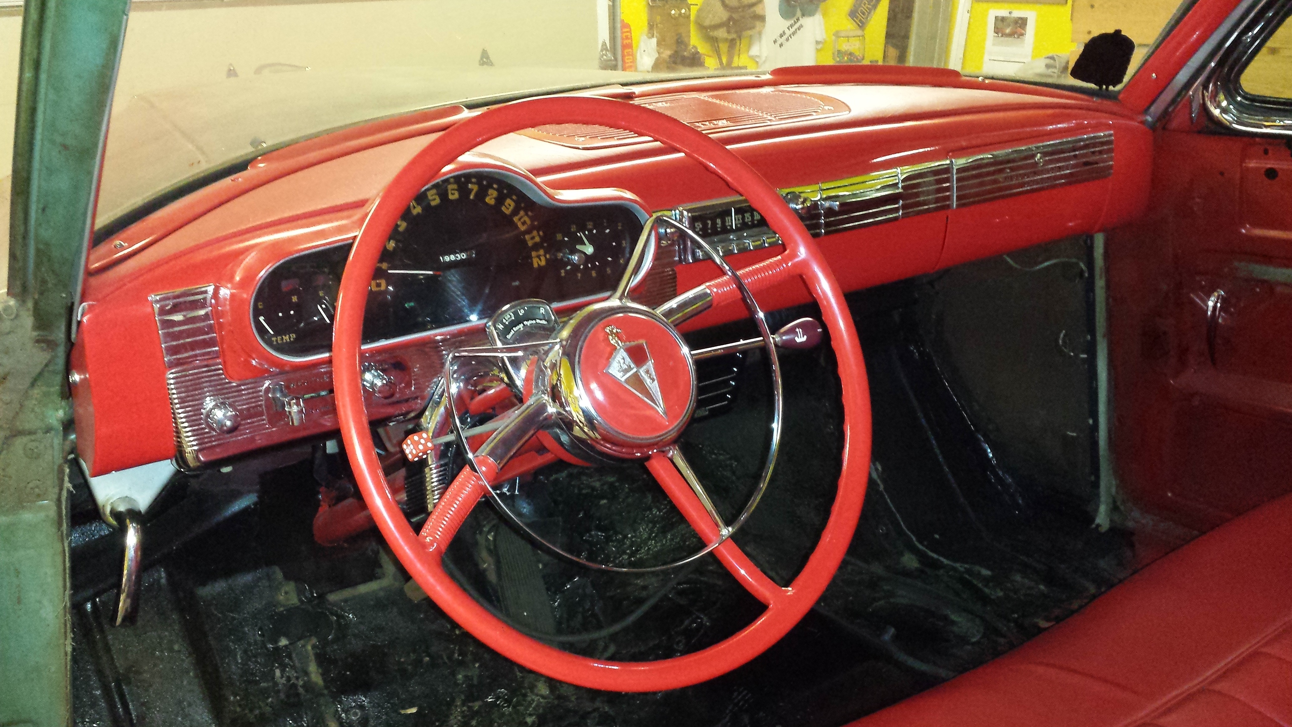

Brownie, you can see the difference between the regular Hornet and the Hornet Special dash if you look at my pic earlier in the post - the regular Hornet has a chrome piece that spans the bottom of the dash.0
