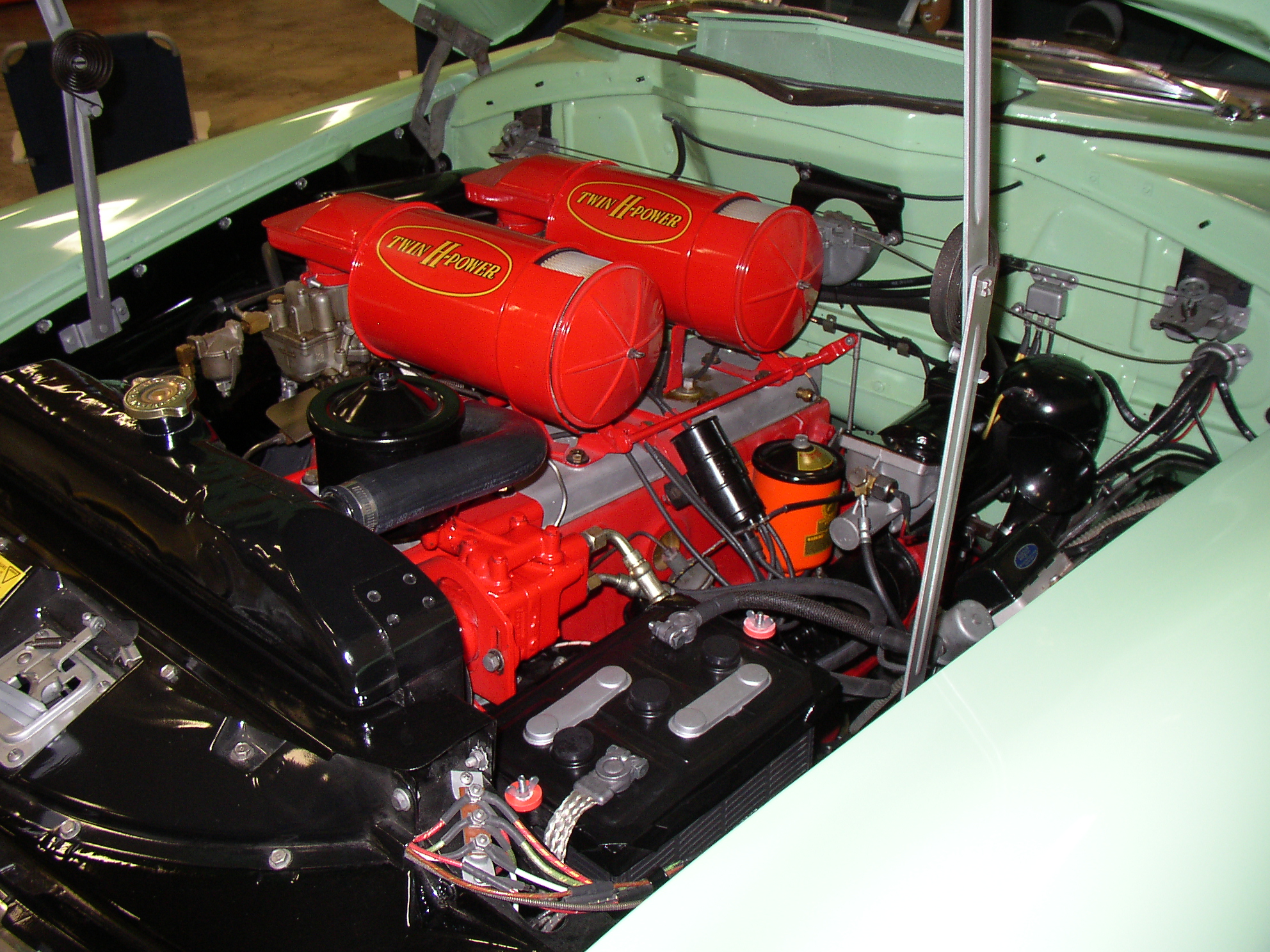

    Bull,
    The pressure switch is attached at the banjo fitting.  It is not uncommon for these to go out.  You can replace the switch without needing to bleed the brakes.  You can perform a simple test of your brake lights by pulling the wires off of the switch terminals and putting a jumper wire between the two wires, a paper clip will work.
    Hope this helps.
    John
    1984 x 1488 - 2M

    John, that's one nice looking engine compartment!

  • onerare39onerare39 Expert Adviser, Moderator
    Posts: 866
    Thanks. That photo was in 2009 when I got it back on the road after the engine rebuild and paint.  I drive it regularly and try to keep everything clean and tidy.
