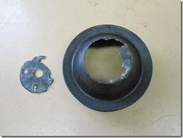

The double WP pulley I had on my step down was only 1/16" thick(an oxymoron)-stupid; mine had cracked around the 4 bolts in a circle. Also the stock single belt pulley I have is 1/16" thick. If all Hudson pulleys are like that, they can work-harden and get you !
Thank goodness for a blinking charge light when the belts started slipping; saved an aluminum radiator.
Point: anything related to pulleys, belts, and pumps can happen !!0 -
