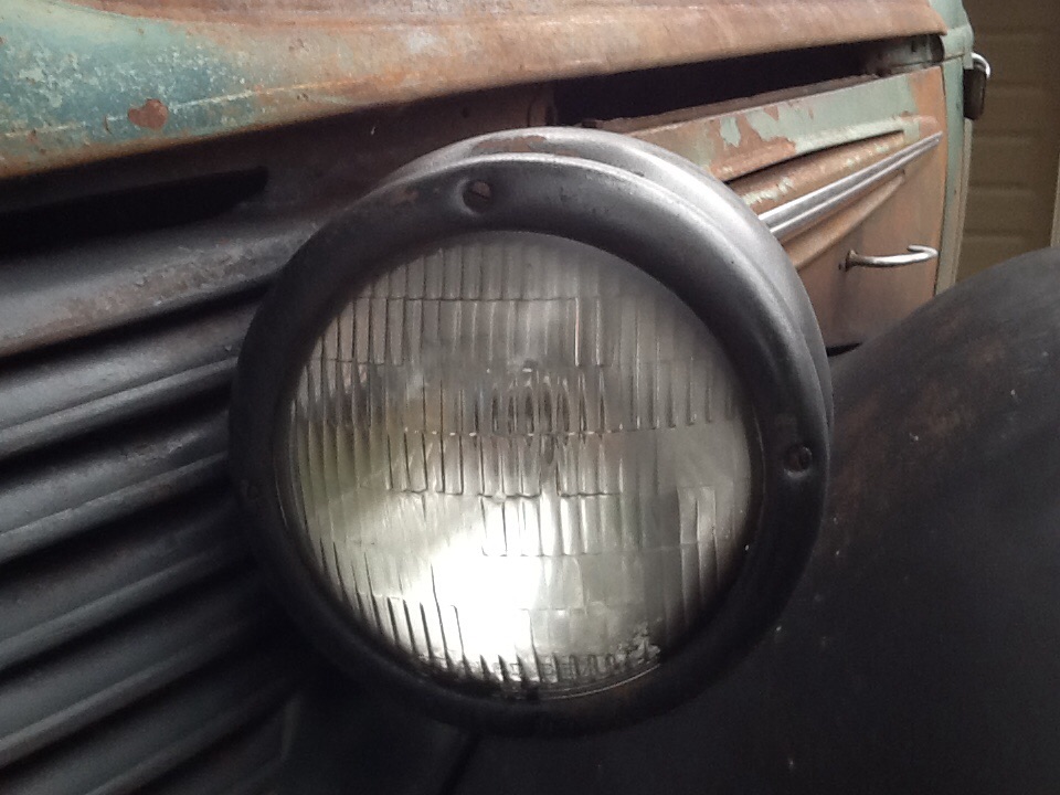

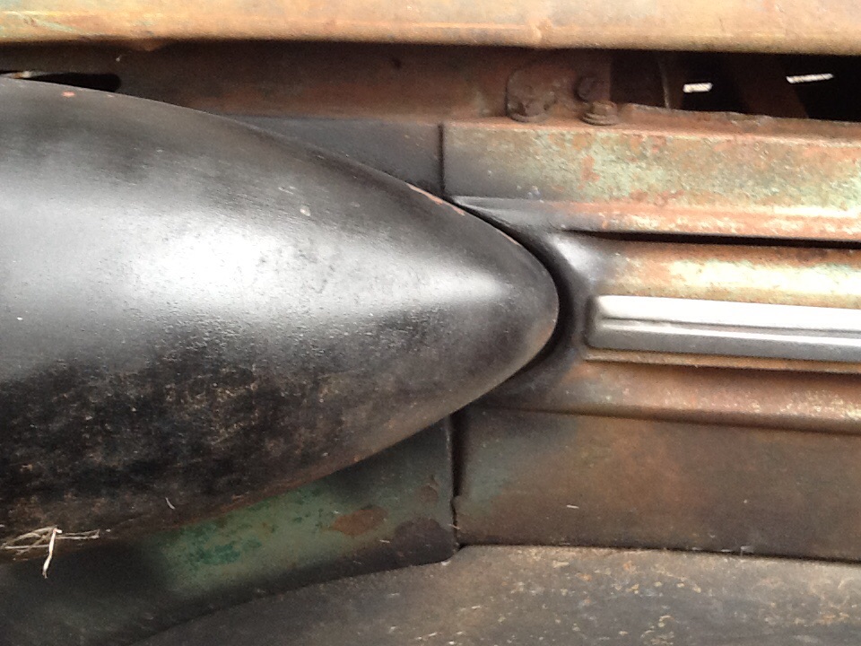

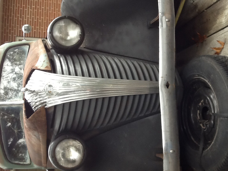

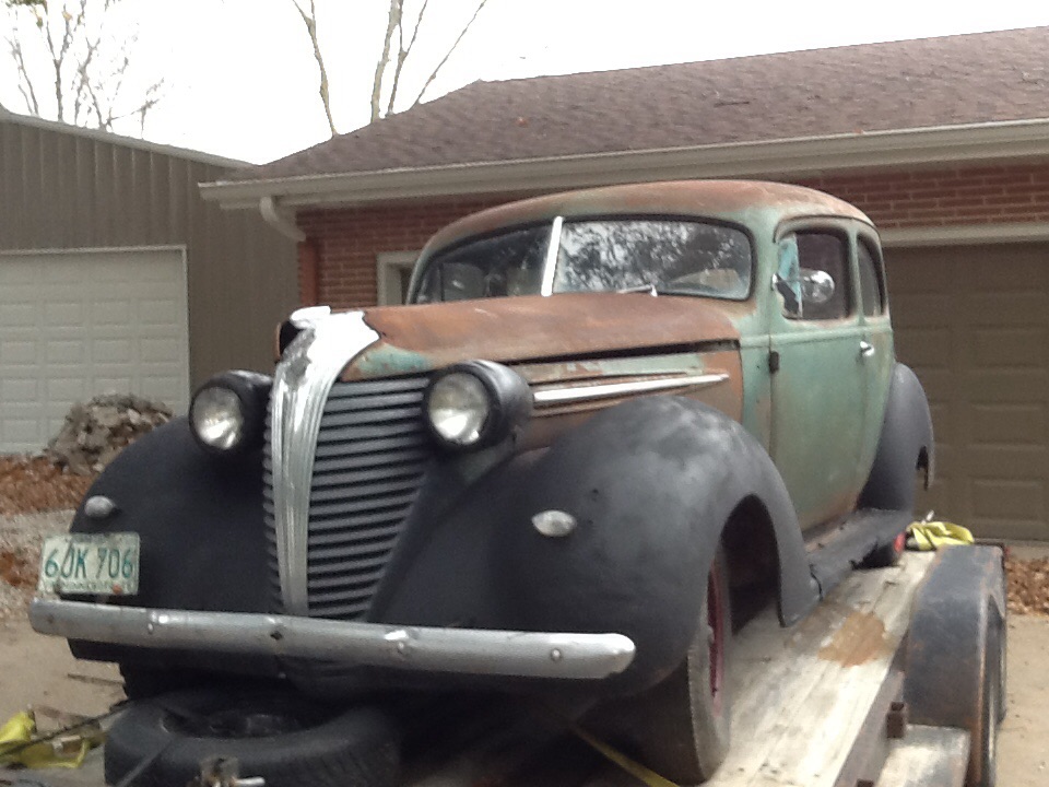

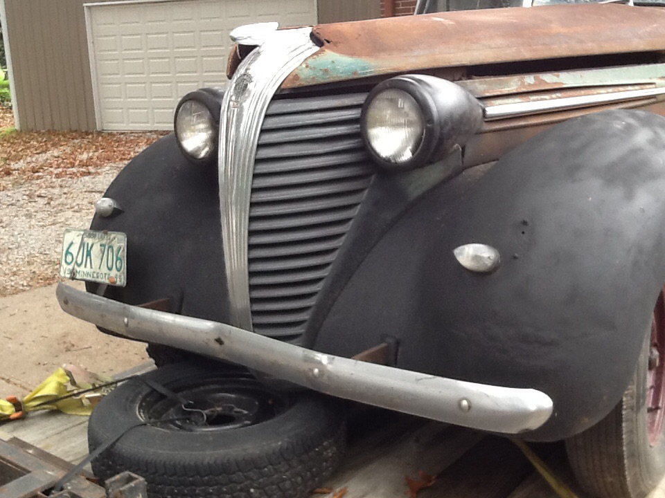

I like the news about 38 Terraplane headlights , thank you to all who responded ! NOW , my Hudson is a 1938 model 81 with sealed beam bulbs in a Housing that bolts directly to the nose of the car on left an right side . They attach as the side panels start to show the vented or slotted strip side panels of the engine bay . Do I have the correct headlamps for this car ?0
david1956 said:I like the news about 38 Terraplane headlights , thank you to all who responded ! NOW , my Hudson is a 1938 model 81 with sealed beam bulbs in a Housing that bolts directly to the nose of the car on left an right side . They attach as the side panels start to show the vented or slotted strip side panels of the engine bay . Do I have the correct headlamps for this car ?
Show us a side view, back view, mounting view...
You may have the correct headlamp housing. But if you have sealed beams, a past owner has installed one of the many sealed beam kits that were offered post-1940, each one designed for a particular make and year.
This was done because -- for many years -- sealed beam lamps were much more powerful than the old 32 candlepower lamps that came with your car when new.
Now, the sealed beams are outdated, and quartz-halogen -- and even LED -- lamps are more powerful. If your car had its original reflector and socket, you could for example install a modern 6-volt quartz-halogen lamp that's been reproduced specially to fit the original socket and reflector common to late-1930's cars.
However, it wouldn't be easy to find the original guts of your car's headlight, since so many of them were replaced with the sealed beam units, just as yours was. So, just stick with the sealed beam unit (you can find replacements for those). It won't look totally original but only hard-bitten old car enthusiasts will know!

You might post pictures of the light buckets (from other angles), just to be sure. That 'modified' bucket just doesn't look right to me...
Also, when in doubt, take a good look at the parts manuals, & the 'Butler Book'.
What bothered me is what looks to be a 'lip' at the top of the bucket, just behind the rim holding the lens/sealed beam headlight in place.
It looks as if the bucket diameter has been modified (bent over, hammered-in?) at the top, to fit the (smaller(?)) rim and lens?
Advise: If you were 'set' on getting back to original or 'original looking' headlamps (quartz-halogen or LED, as Jon indicates) - I would set it as a 'long term' goal, and keep those headlamps in place until you have accumulated the parts and pieces to do it.
