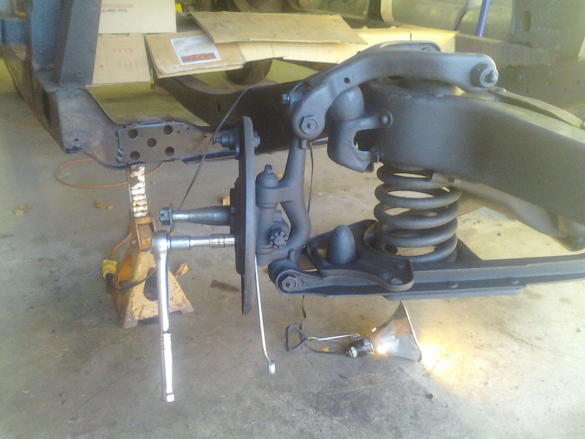

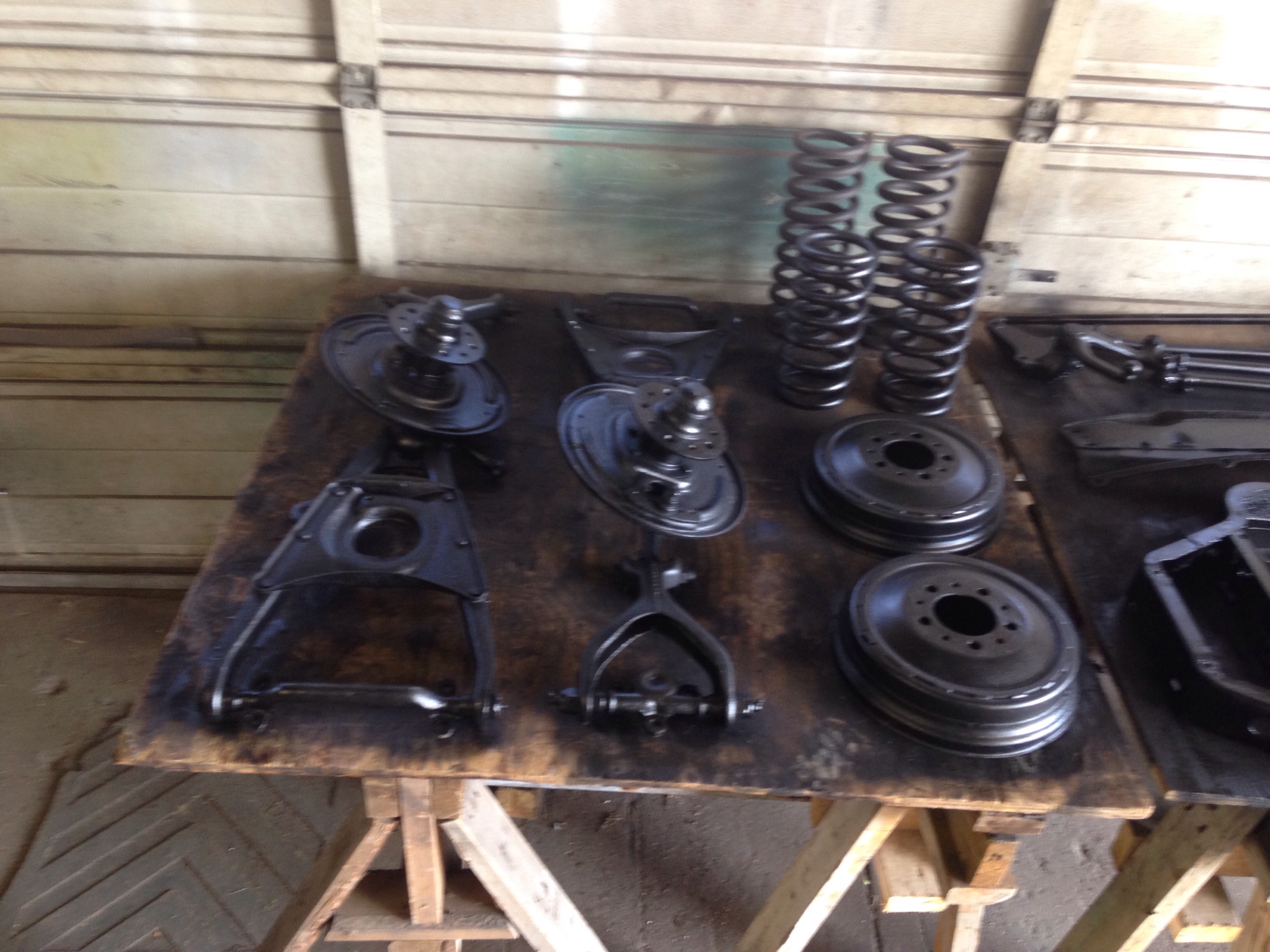

Jason, If you had both control arms off for cleaning and painting. is it possible they got switched left to right? the arm on the spindle for the tie rod end will go to the rear of the car. If you could post some pictures of the control arms it might help to identify the problem. Hope this helps and good luck with your project. Keep us posted thanks. Preston-triman620
thanks all. nothing was removed, simply followed the book procedure to get the coils out. did more research on here and it seems to be fairly common to need to use longer bolts to locate the control arms to crossmember then replace with correct ones to cinch it up. for all the "easy" stuff i had done before this past week has really questioned my choices lol. ill get to it but there will be moments of doubt and frustration, but it will get done.thanks for the continued help.- jason0
thanks Ken,made some progress last night. I have an internal spring compressor on the coil to keep it under control. Then I used varying lengths of all-thread and bolts to get the lower arm up and aligned with the crossmember. Going to get a little longer than stock grade 8 fine-thread bolts today so I can try and cinch it up. Then I'll slowly release the internal compressor tool and put the wheel on. THEN i can finally try and start the thing lol!!0
Jason,I think the bushings are eccentric. Maybe you can get the little bit you may still need to get the bolts in by turning the bushings. Naturally the alignment will need to be reset.Per0

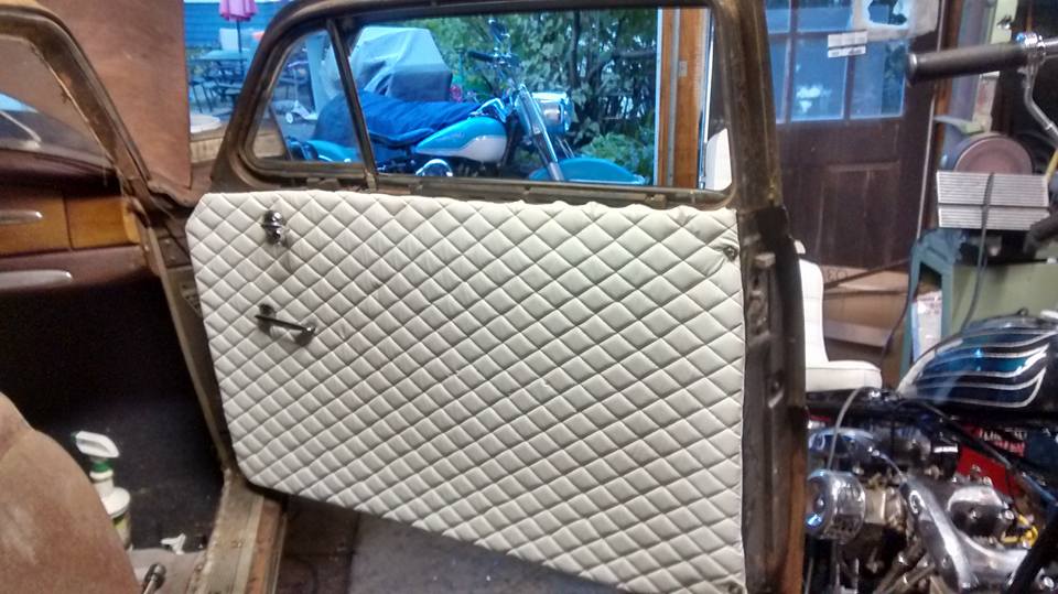

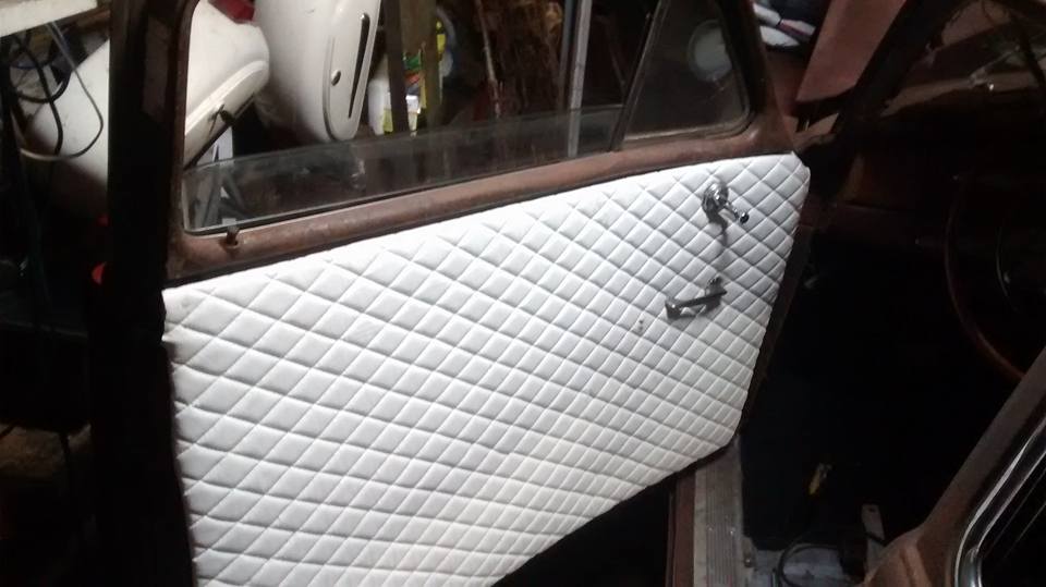

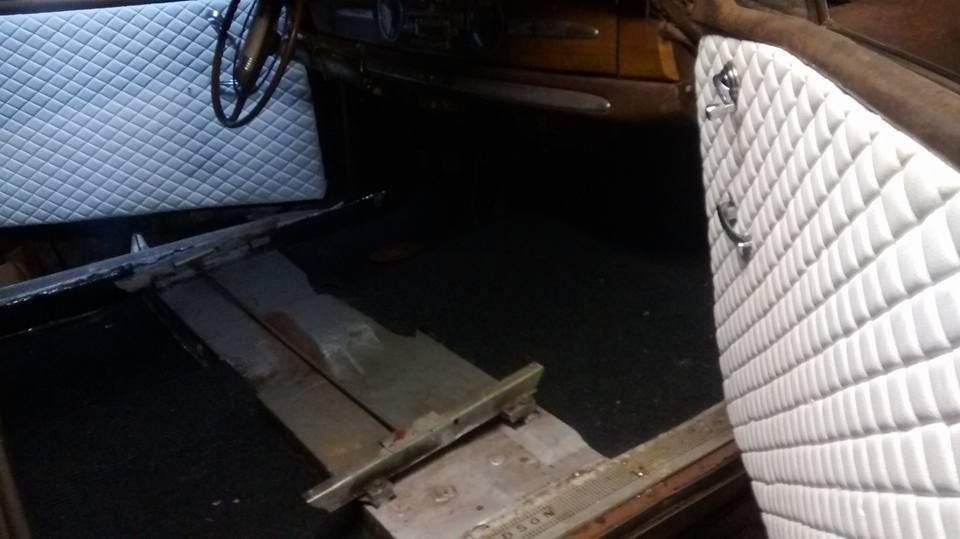

thanks all - and thanks Quadster for that pic!I have made a good amount of progress: coils are cut 1 inch and installed, crossmember back in place, control arms installed, dipper tray cleaned and installed with new oil, oil pan installed with new gasket (havent added oil yet).Going to hopefully attempt to fire it this week. trying to find a 6v battery to use to test.also made up some door panels last night. have to make an extension for the window crank to extend past the flat panel. i have saved all of the original parts and doing my best to walk the line between hot rod and stay true to the car and not do anything that cannot be undone in the future.0
