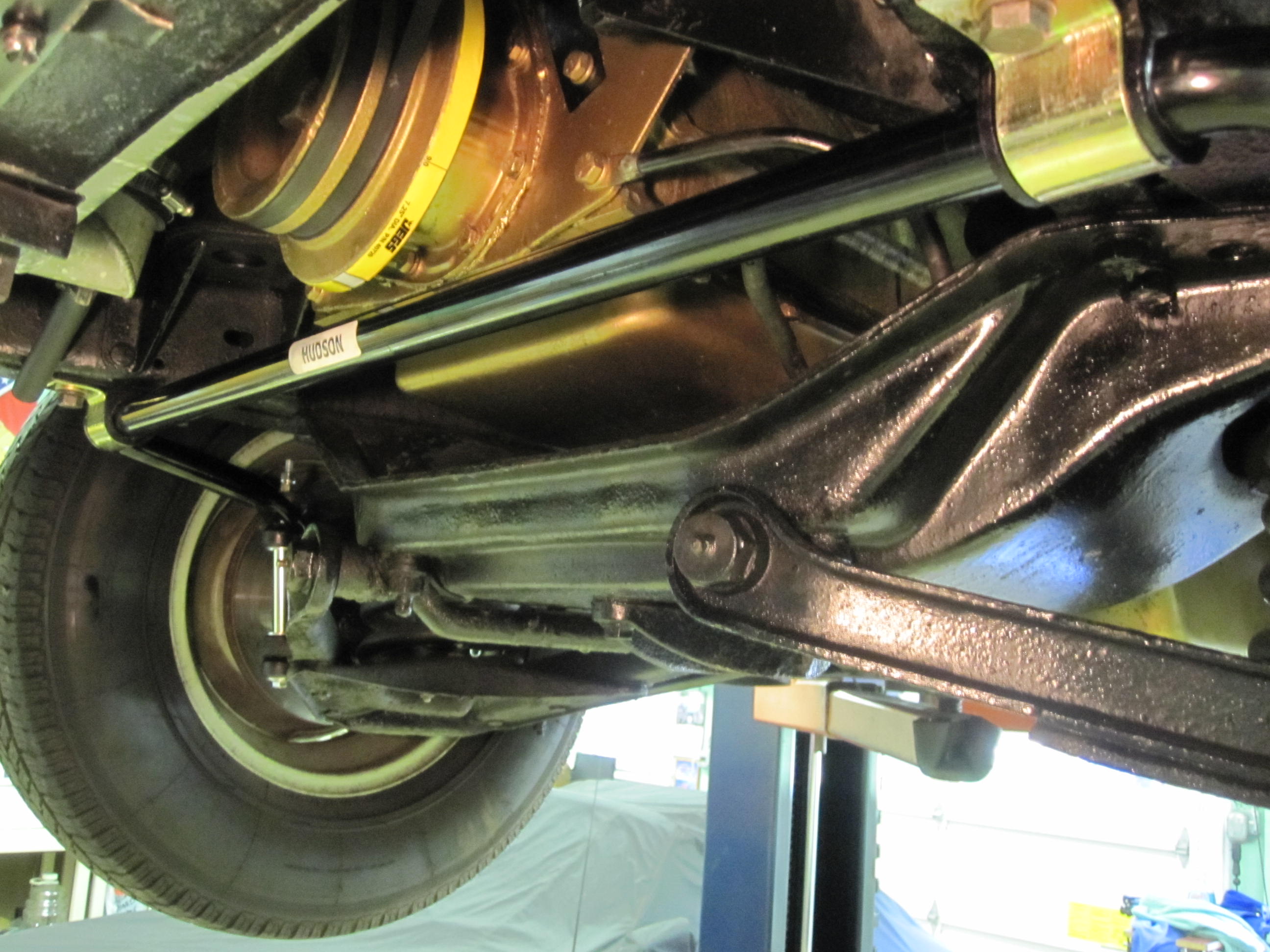

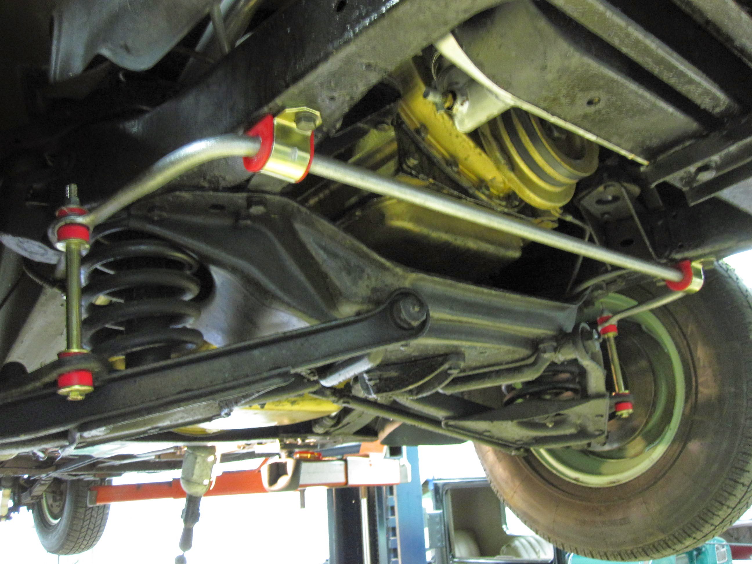

    To 'whet your appetite': HD bar vs orig anti-swaybar
    1st is HD bar
    2nd is stock bar but with new links and poly bushings {if you don't get an HD bar, for goodness get aftermarket links and poly bushings; but get links that will make the bar arms level with road; my aftermarket ones shown with orig. bar are too long~~}

    Thanks for posting the comparison photos.

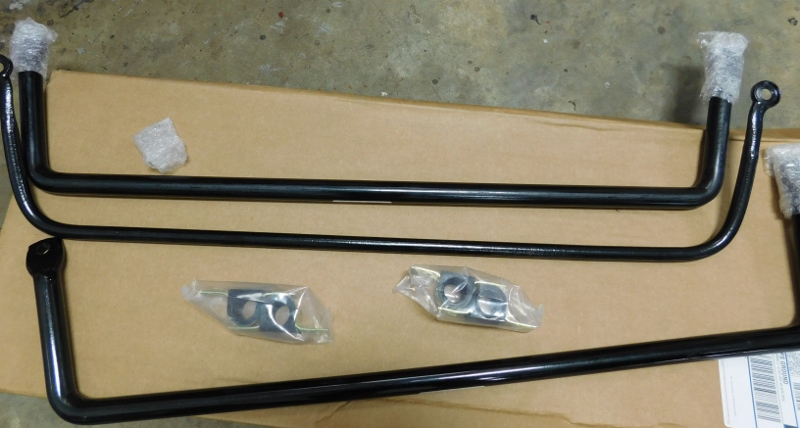

    Another showing difference. The cross section area of the HD bar is 2.3 times the area of the stock Hudson bar.
    PIE are square !!!
    top & bottom are HD
    middle is OEM

    For us non-matheticians,
    What was the OD of the original anti-sway bar?
    And what is the OD of the new HI anti-sway bar?
    Did Hudson offer a Severe Usage sway bar and if so, was it the same ID as this new bar?
  • RichardDRichardD Member
    Posts: 363
    orig: 3/4"
    HD: 1-1/8"
    no info

    photo of stock and HD bars {0.75" vs 1.125"}; stock bar in center; HD bars top and bottom.
    click on photo>>
