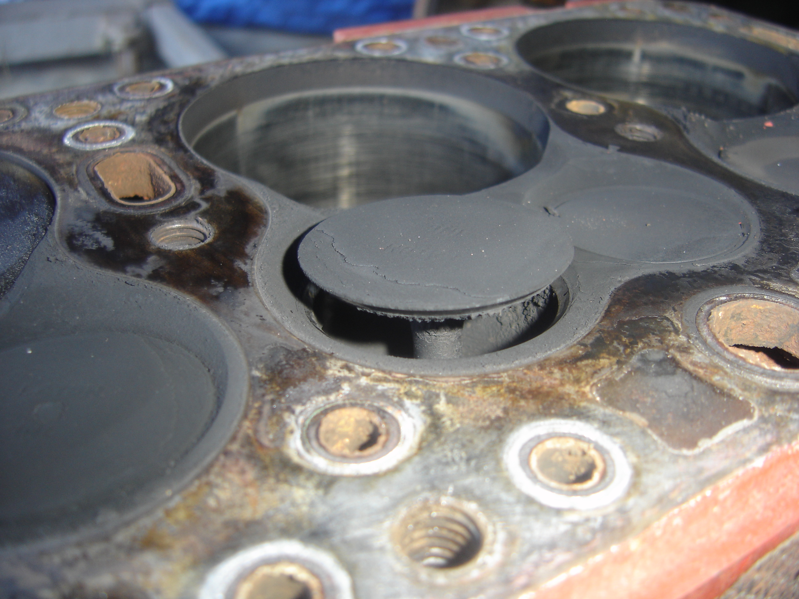

I pulled the head, and the valves look to be in good shape, except for a lot of carbon. No indication of recession. None of the valves were stuck. I may not need a full rebuild.
