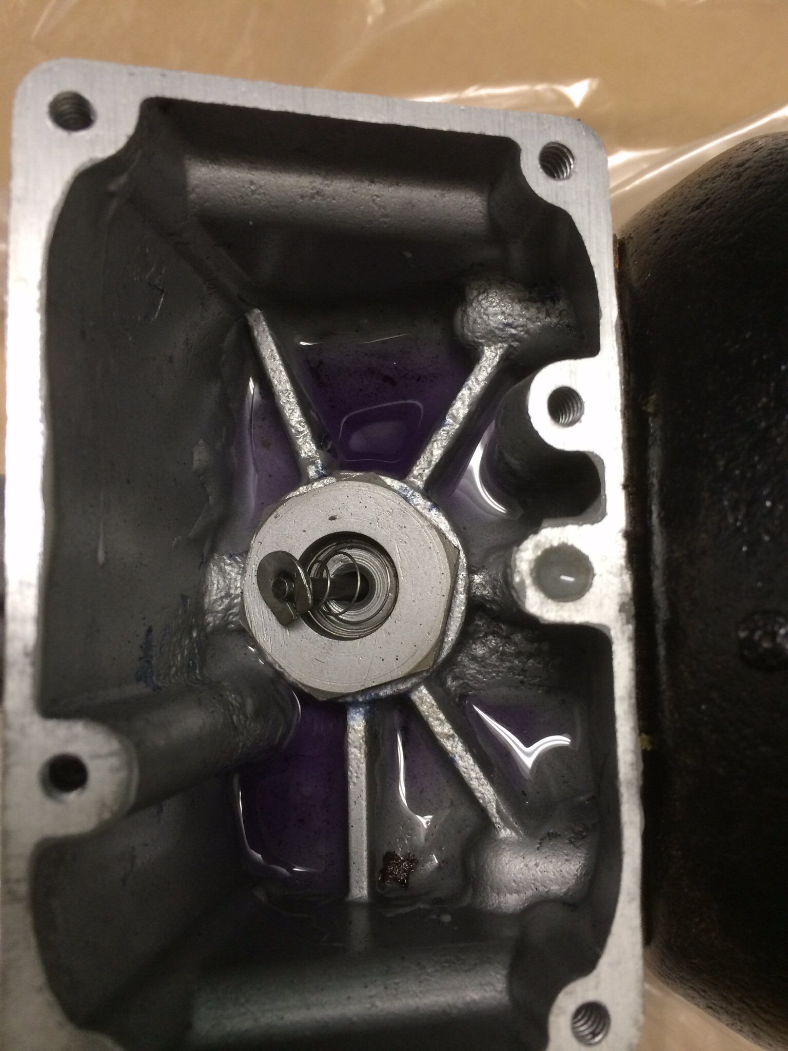

I think I found the issue. When I removed the cap for the master reservoir, I noticed the little pin with the spring seems bent. Does anyone know if this rod should be perfectly straight? I am assuming it should be as the spring seems to create the seal for pressure to me. I have the unit all packaged up at this point to return it, but I am hopeful if this piece is the culprit that it is a relative easy (and inexpensive) fix.0

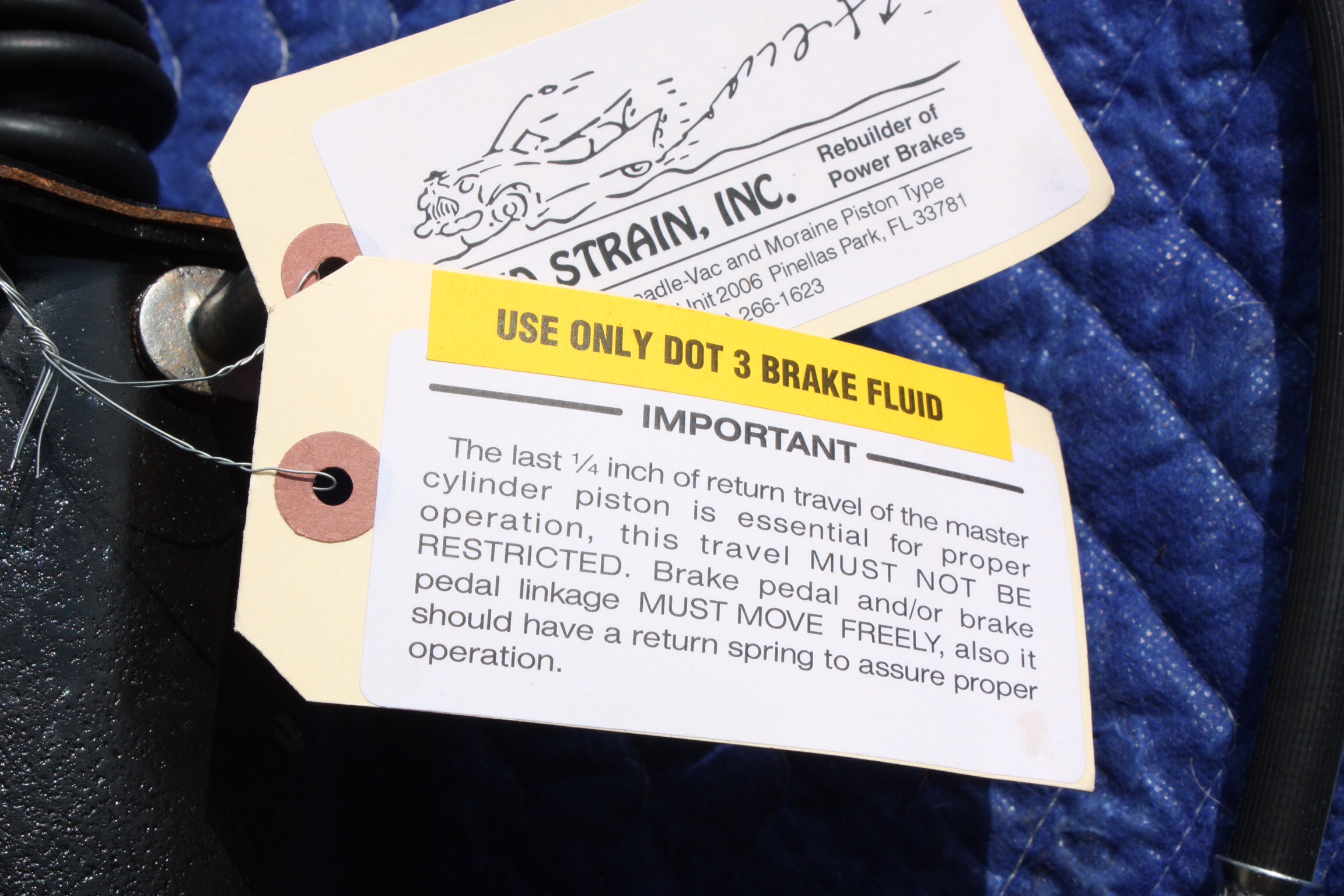

Great pic to keep for future reference, thank you Ken! (Also a great reminder that I am in over my head on this one. yep...Ed Strain here I come. Have a Hudsonly Sunday!0
Whelp...I received the master/booster back today and spoke with Ed Strain. Sure enough, it was the compensating valve. Ed replaced the bad valve and returned it. (He does fantastic work, by the way.) Before I reinstall the unit, I want to revisit the DOT Brake fluid question. Ken, I know your thoughts on the DOT 5 fluid, and I appreciate your feedback. Does anyone have a different opinion about DOT 3, 4 or 5. The unit says use DOT 3 only, but I received advice from several Hornet owners that swear by the DOT 5 and have not had any issues with it. I'm a bit gun shy on what DOT to use for this redo? I'm open to any opinions and will hopefully make the best

SkyDad,I would ask Ed why he specifically says to use DOT 3. There must be some reason that he is very specific about that.John0
