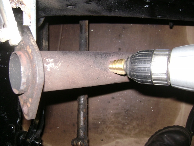

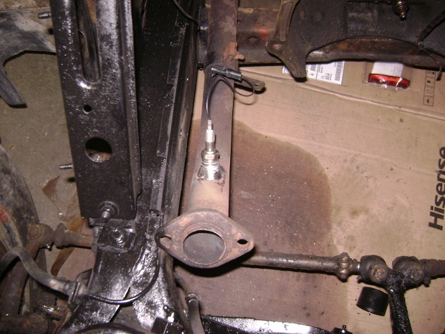

Bill, what are you using for the 02 bungs and sensors? Where do they need to be placed? Do you use one in each 3 tube head assembly or one in the exhaust system H pipe?
Kerry,
All my personal stuff is R&D so it's a little different.

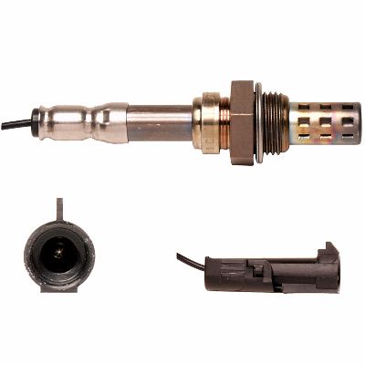

For normal operation a 1 wire O2 is placed close to the manifold to allow it to get up to operating temp quicker.
Only 1 is needed.
The sensor needs to be about 600* before the system will consider it's reading accurate and allow "closed loop" operation.
I normally place mine in the header pipe just below the manifold. With headers I run the bung in the collector.
There's no need to run the O2 back behind the Y or to have a sensor in each collector on duals.
You want to keep it as close as possible for the heat and the delay in signal due to the distance from the engine.
My kits come with the O2 sensor and bung.
Keep in mind that if the system is tuned for the engine then just like a carb, it doesn't need the o2 to operate. What makes the EFI different is the use of the O2 sensor to provide constant feed back(closed loop) back to the ECM to make continuous minor fuel adjustments as you drive based on weather, altitude and engine conditions. Something a carb simply can's do. What you get is what you got until you re-jet!
