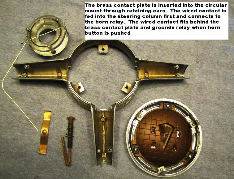

Thanks Ken. I had a few parts in a plastic bag. So,I am just missing two 1-3/4 4-40 screws, contact strip and the spring that goes under the wire connector. Your description refreshed my foggy memory of the last one I did on my" Clabbered up" 49 Super several years ago. Maybe if I sweep the floor I'll find a few more parts ! LOL

J Lombard-They are the same.0
Oh by the way,, the three screws are 6-32 not 4-40. lance had the parts I needed. They are on the way.. if no one steps up in the mean time.... I'll take a picture and post it once I get the parts together.0

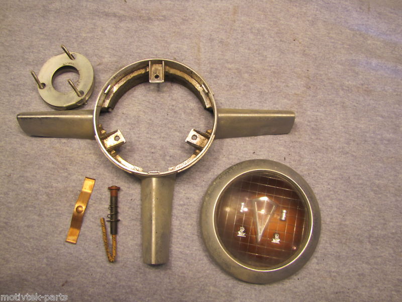

The attached pictures are of the horn button, mount and the components that make up the horn grounding ciruit.0
