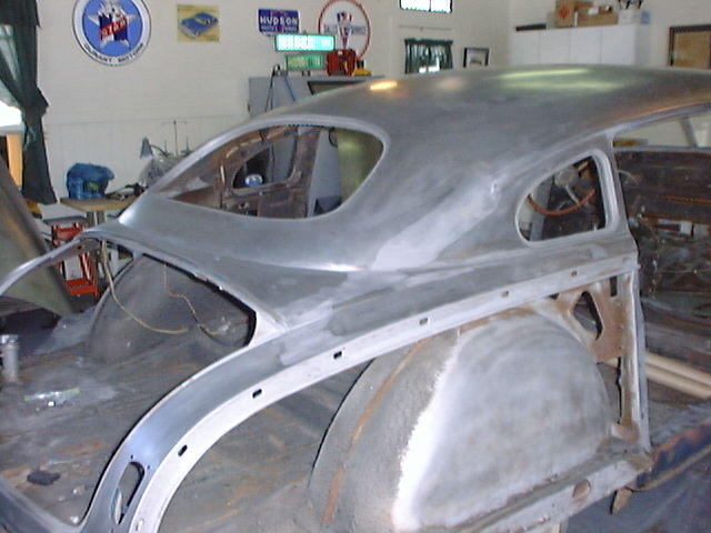

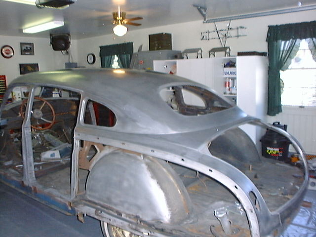

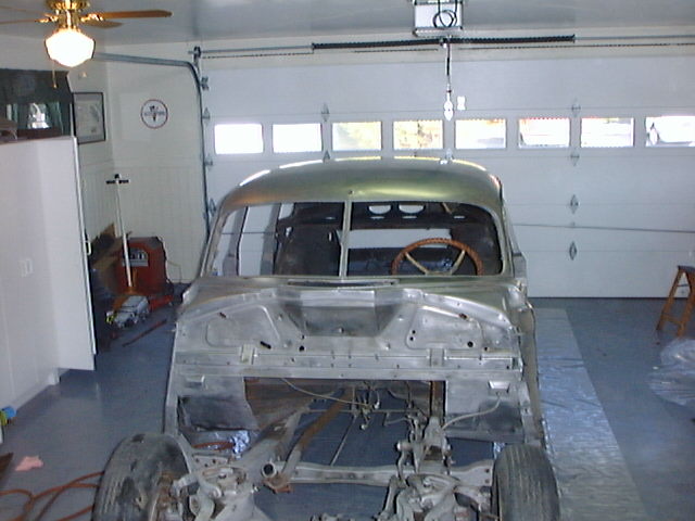

Here are a few pics of my 49 when I got it back from being plastic beaded. Don't be surprised at the amount of damage the beaded uncovers.
The car doesn't show any sheet metal on it as I had that done separately. Good thing I did as my straight, slightly used car with 49K mile on it had prior damage on the front fenders and one door. The rear fenders had been bumped and fixed a couple times many years ago too.
Now the care is truly a rust free, bondo free car. I replaced every sheet metal peace, except the trunk lid, with NOS replacements. The few small dents uncovered in the NOS sheet metal were metal finished, not banged out and filled. Took a ling time
