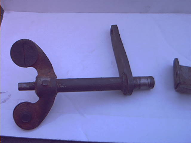

Check the clutch bell housing cross shaft bushings for wear, these are apparently always worn out. On my gearbox, the throwout bearing fork was very worn too. Doug Wildrick sells a kit to replace these parts.

The Hudson clutch throw out bearing mount cross shaft is mounted in the bell housing and it is operated by the clutch pedal and it's associated linkage. This piece of the SYSTEM is very vulnerable to the dirt kicked up from the road surface and over the 60+ years of life it will wear and when it does the clutch adjustments shown in the maintenance manual CAN NOT be achieved. The inspection and repair of the frame mount bracket for the clutch pedal paddle interface is ESSENTIAL. If wear is found correct it, check fit with the shaft both at the mounting bracket, alignment to the bell housing paddles, and that the shaft that enters the bell housing is straight and properly fits the rubber bushing found in the bell housing. A must is replacement of the rubber inserts which fit on the clutch cross shaft paddles and the bell housing rubber bushing.
Finally clean each piece of the linkage, paint and lubricate when re-installing. When re-assembled the cross shaft linkage should have a fiber oil washer installed at the end where it enters the frame mounting bracket . As all surfaces are metal to metal they should be regularly inspected, cleaned and lubricated after repair re-installation and adjustment to manual specifications.

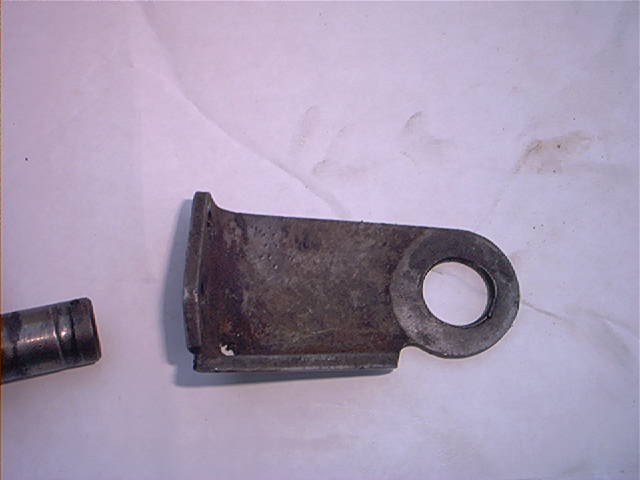

Old farmer is right on. a few years ago I was having trouble with my 51 Pacemaker not releasing. The clutch and cross shaft bushings were new a while back and I found the trouble in the worn frame bracket /shaft and clutch pads. It is fine now. I do however suspect that the clutch fork and releas bearing collar may be worn where it rides on the release bearing. I have a couple of old ones that are worn for comparison.. I also have a NOS collar and fork if I ever need them.Jim SpencerWestern New York Chapter0

I have added Hudsonite fluid that a friend in the HET Club supplied me, and had the the cork disc redone along with throwout bearing by Ron Fellows. I plan on inspecting the linkage this weekend, does anyone sell these parts?? brackets/bushing/fiber washer?Old farmer is right on. a few years ago I was having trouble with my 51 Pacemaker not releasing. The clutch and cross shaft bushings were new a while back and I found the trouble in the worn frame bracket /shaft and clutch pads. It is fine now. I do however suspect that the clutch fork and releas bearing collar may be worn where it rides on the release bearing. I have a couple of old ones that are worn for comparison.. I also have a NOS collar and fork if I ever need them.
