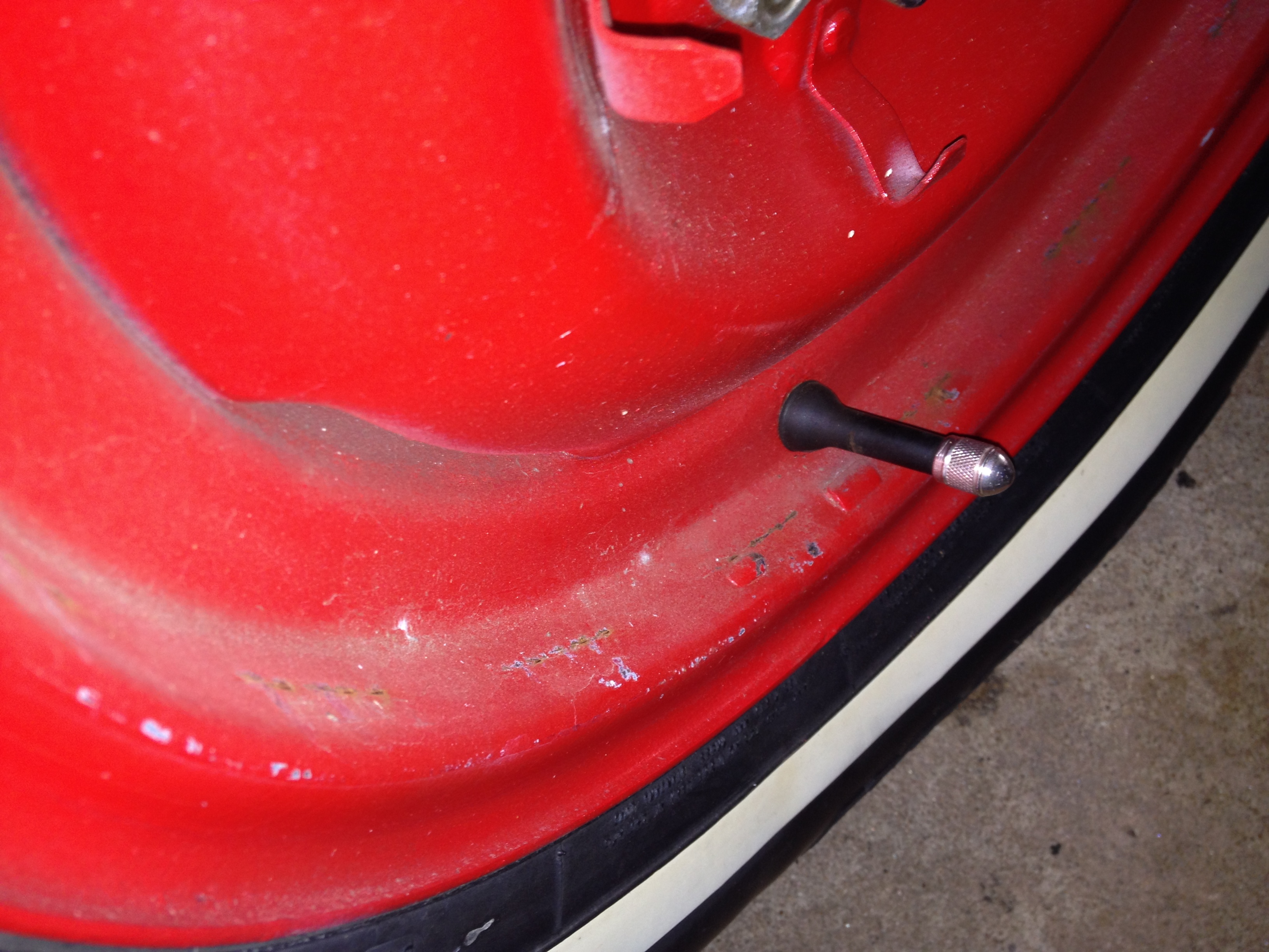

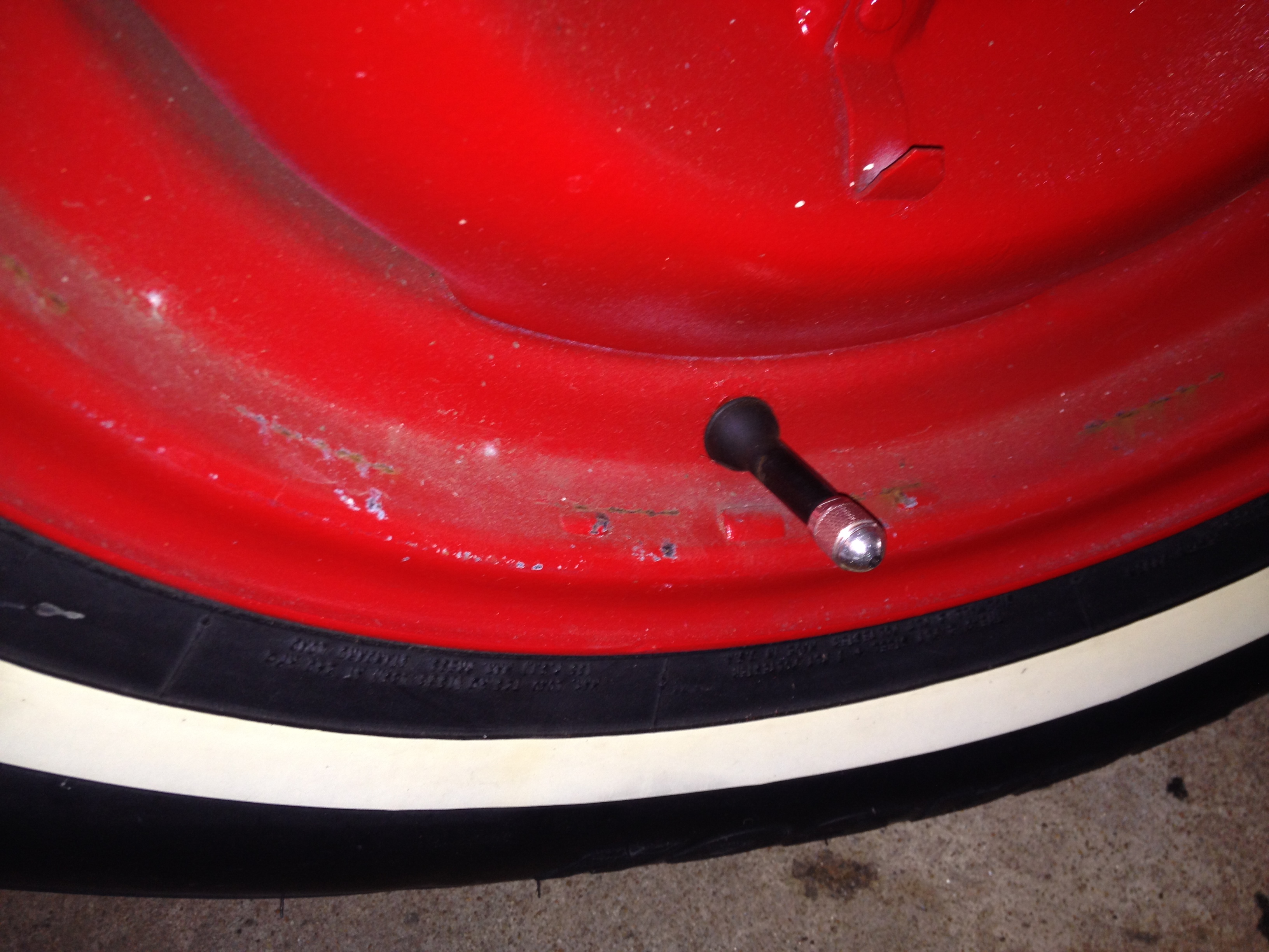

This is also what I didn't know on my 54 wheels that help to keep the caps from shifting. These are pics of my left front. You will see two bumps on either side of the cap. In one of my (duh) syndromes I thought if I filed down the one on the right rim the hubcap would go on easier. WRONG!! They were there for a reason. My friend this next week is going to weld a new bump on for me so the left hubcap stops shifting.
I've had to re position it about every two drives. I'm sure not all rims have these, but just wanted everyone to know what they are there for..0 -

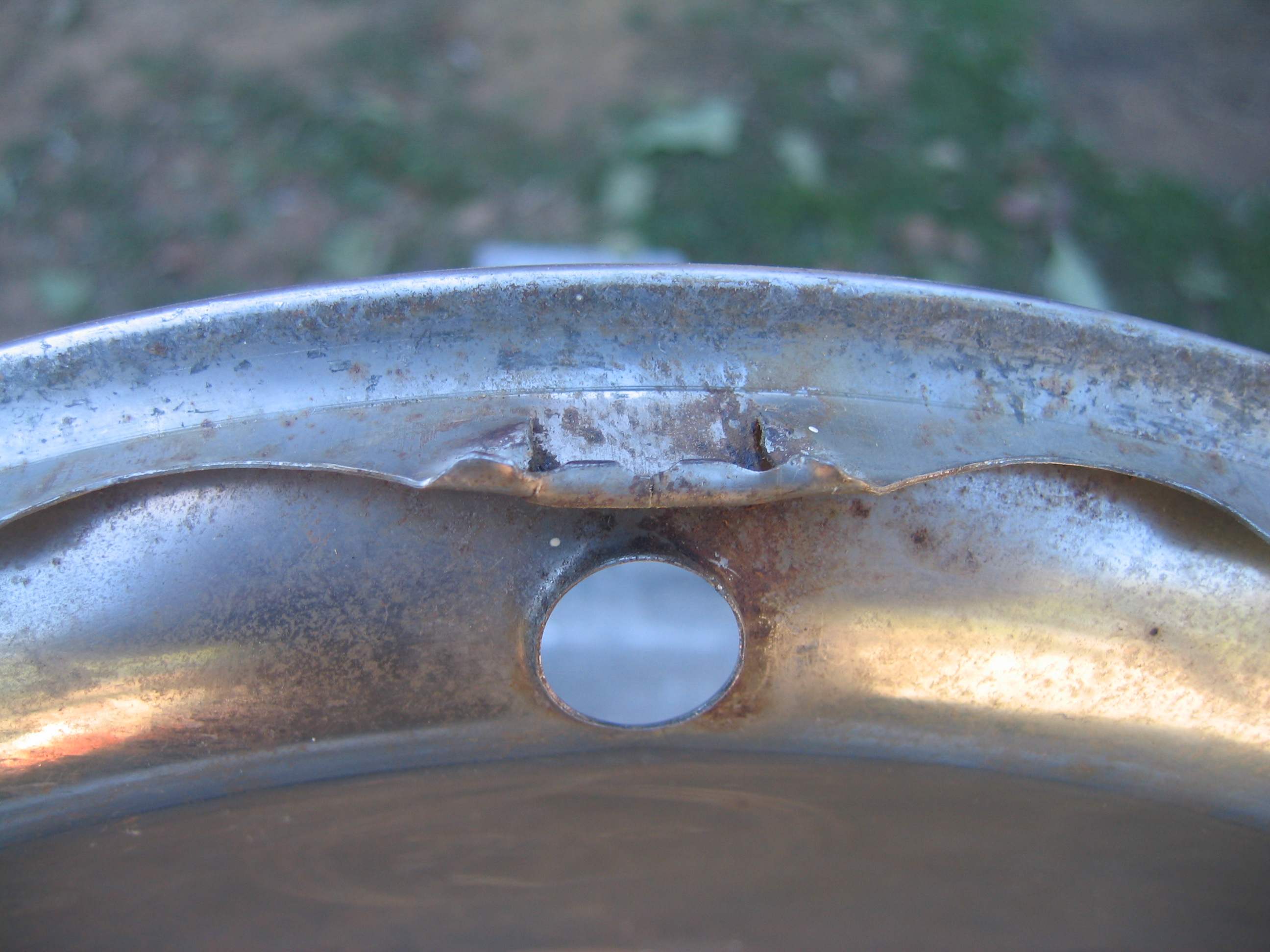

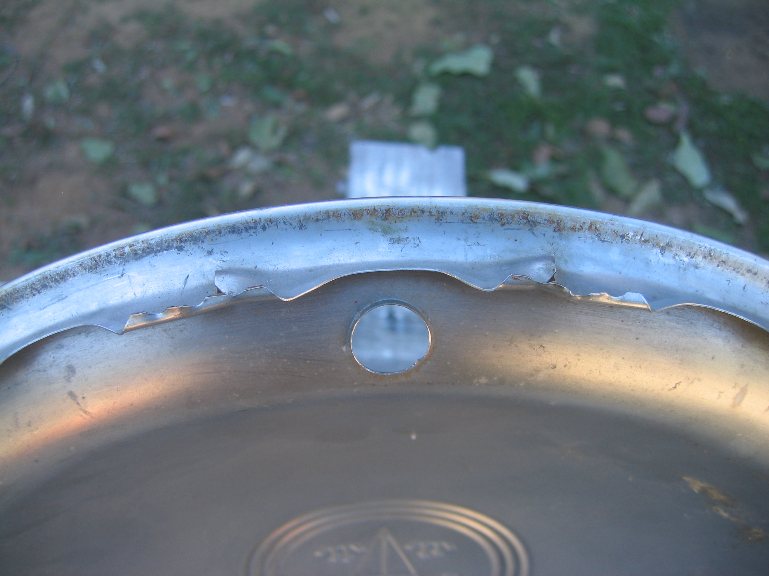

Rocket,I doubt that the full size 36 caps would actually come off given they are held on by the 5 central spring clips.They may well rotate though, and driving is probably the only way to determine that. There could well be a reason why those caps were a one year only item.I like the idea of using the brass/stainless valve stem.Hudson vs Jet wheels and full face hubcaps.Believe it or not, the Jet and Hudson full face hubcaps used 2 different anti rotation methods on otherwise identical hubcaps, and both will slice your rubber valve stem if they are used on the wrong wheel.The 54 Hudson wheel had ONE lump on the rim next to the valve stem and the hubcap was made to suit that one lump.The Jet wheel had TWO lumps about 1" either side of the valve stem, and the hubcap was made to suit those two lumps.Looking at Hudson Granpa's photos it looks like Hudson may have got a bit smarter during the year and supplied wheels with 3 lumps so the hubcaps could interchange.0
A couple of photos to show the difference in anti-rotation detail between the Hudson and Jet full face hubcaps.Hudson is the first photo.0
