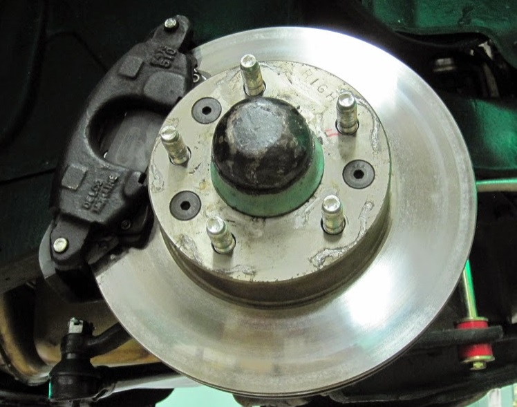

I am glad to see the disc brake kit back in production. I'll share some experiences and thoughts about the stud shoulder I see in the picture. This is not ment to be critical but something to be aware of when installing wheels with stud shoulders protruding past the hubs face.
I noticed in the photo alot of the untreaded part of the stud shoulders are protruding above the hub face. I have come across this many times on customer cars that came into my shop when bad studs had been replace with new studs and the stud shoulder protruded past the hub face. Original factory stud shoulders do not protrude past the hub face. The problem was that the end of the tappered nuts would bottom out and tighten against the tappered stud shoulders giving a false sense that the wheel was tight when in fact the wheel was not tight enough or not at all. Because of multiple tire changes and overtightening lug nuts or bolts the holes become larger so the nut or bolt taper will get closer to the hub face or stud shoulder which may cause the nut to bottom out. If the nut bottoms out on stud shoulder, the torque between wheel/hub will not be sufficiently tight. Without sufficient torque the wheel can move around which leads to larger holes and a junk wheel.
Of course with the use of the wheel spacer this should not be a problem with a good wheel. Could the hub face be made thicker to eliminate the need for spacers?
I hope this will be helpful.
Lee O'Dell
Lee,
I knew I was asking for trouble posting the pics of the first parts:). The studs were immediately identified as as issue and replaced with a part with a shorter shoulder. I replaced the first set of studs and test fit everything tonight.
The new stud has plenty of clearance so that rotor sits completely flush on the hub face with additional clearance. The nut does not bottom out even if the wheel isn't installed.

Here is a pic of an OE hub compared to my new ones. Note the beefed up flange to give a bit more strength for the press in studs and the deeper center to keep the rotors hub centric. Plus they're shiny

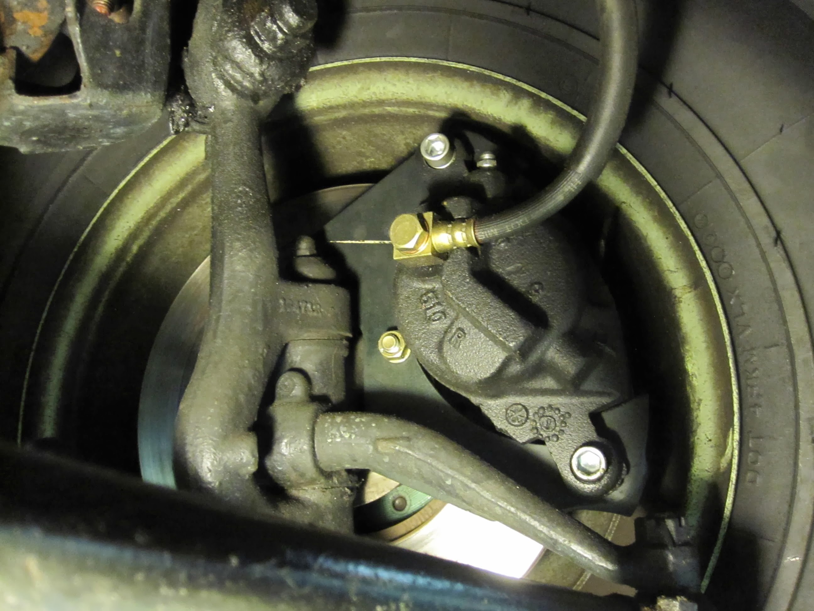

I bought a kit back in Jan. Let me start of by saying Matt was great to work with and is there to help any way he can. I have a 42 super six that I put the kit on. I did have a problem installing the backing plate bolts supplied to short. Matt was not aware that the sway bar attach to the lower bracket and sent me the replacement bolts. It took all of about a hour to install the kit. only mod needed was to cut out part of the caliper to allow the hose to fit correctly as stated in earlier post. I put a firewall mount MC on my car with a p-valve out of a 76 corvette cars weighs about the same and has 4 wheel disk brakes.
